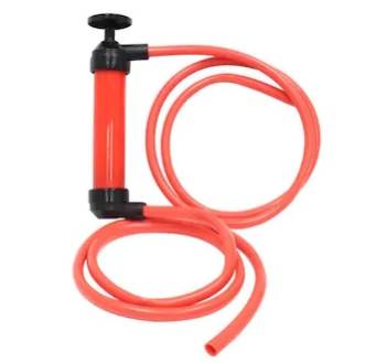

Who would want to go through all the trouble to drop the third member out to drain the lube when a $13 hand pump can do the job.
I've used one like this twice now and it removed all of the lube except for about 1/2 a pint. Made by Hopkins and it's found in most of the parts supply stores.
