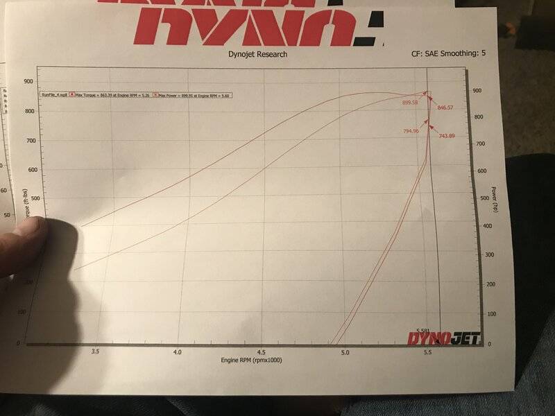

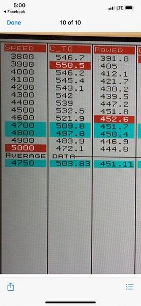

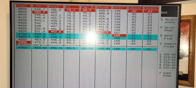

Is there a dyno sheet that goes with this screen shot?
It appears the TQ numbers are “corrected”(the “C” if front of the tq), and the HP numbers are uncorrected.
Although, there doesn’t appear to be much of a correction factor.
Be nice to see the other info that might be on the sheet...... like bsfc, fuel flow, etc.
Was it tested with headers on it?
600 hp will about incinerate any tires from a roll.
