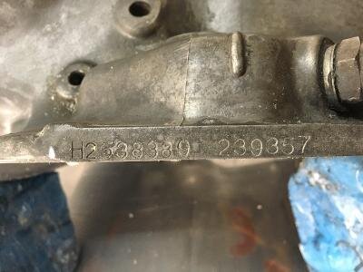

I just bought a original transmission for my 1966 Coronet 500 Hemi. I know the part number is correct as H2538389. What I am not clear on is the next set of numbers right after the part number in the same stamping size 239357. It doesn't seem to follow the 10,000 day calendar?
We can help better if you post a picture.

Sorry, it was fat finger syndrome, but while I am here I will shed some light on your question. The number after the part number has a digit missing. It should be seven digits long on pre 68 transmissions. It is not a 10,000 day calendar date, which started in 1968. It is a sequential serial number. I have a photo of a 1962 trans that has number 0000007. Sorry again for the red X. I might get one myself, as some people don't agree with me on the pre 68 numbering system.
