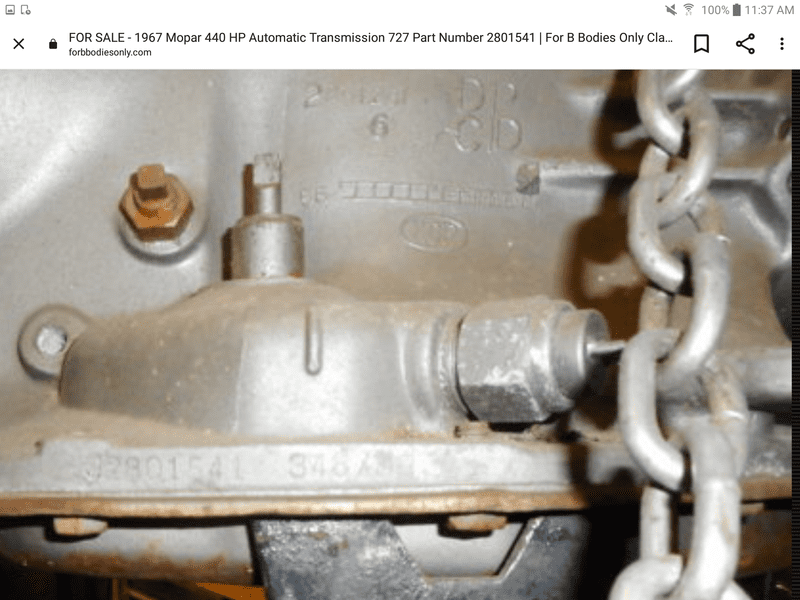

Thank you for the info, it is interesting to me. Like most things chrysler they generally phased things in and out. In this case the transmission format changed in 1968, but your example proves they started a little early. The first of the two four digit numbers , is the 10,000 day calandar as everyone knows. It is the earlier transmissions with the seven digit number that do not have a date code. I have seen post 68 transmissions with a digit missing, but I' m not talking about them. The pre 68 units with a seven digit number do not have a digit missing. As I have mentioned before I do not look a one example or picture and form an opinion based on that. 30 or so years ago I noticed that the number afer the part number on my 66 trans, made no sense as a date code, I have been looking at trans numbers ever since, whenever I see one, or a picture of one. My trans had a 66 casting date and a 1970 build date if you applied the 10,000 day date code to the numbers. What is the chance of a 66 casting date housing being in a trans. plant in 1970. I have enclosed a picture of a 1967 trans. that shows the same thing. I have seen many more examples in the last 30 years, and yous is the only one i have even heard of with the two four digit numbers on a pre 68. The only thing that makes sense is to manufacture extra transmissions for the parts dept. while they are at it. If they run out they will sub up to another one that will work for the application. They are not going to dust off the 1967 blue prints and build a 67 trans in 1971.

I took some time and searched thru the other 2801 transmissions, and you are correct the seq numbers on those are no way a date code, they are way to high to be any 67. so I stand corrected! Your observations were correct.
my GTX is 2801541 3353342, so 28 sept 66 would be the 1885th day or so from 0001
