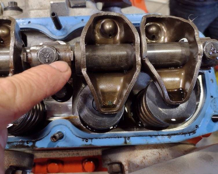

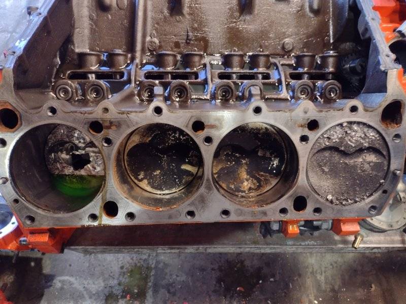

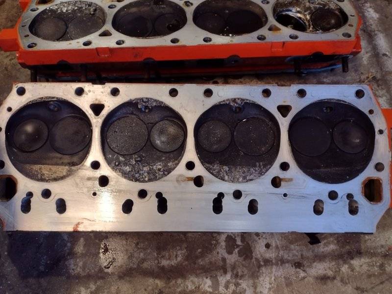

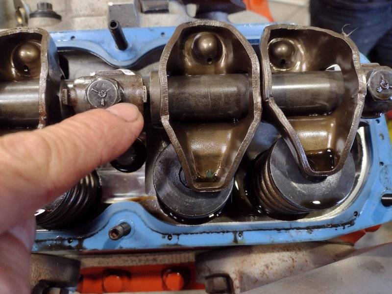

Those don’t look anything like 440 Source heads. These are my new Stealth heads going on my 440 build.Yesterday a young lady brings me a hurt 440 out of her expensive 70 resto mod Charger that she recently purchased. The engine has under 400 miles and suffered some major damage because whoever built it missed the mark on the details. One clearly missed detail is a rocker arm spacer on the other bank was in the wrong position.
Why do people run those crappy stock rocker arms and 5/16" push rods in anything but a stock cammed engine!?! Dual springs with high open pressures have no business under those rockers arms. Making rocker arm skewers with push rods should be a clue that those rockers are not up for the job when high spring pressures are used.

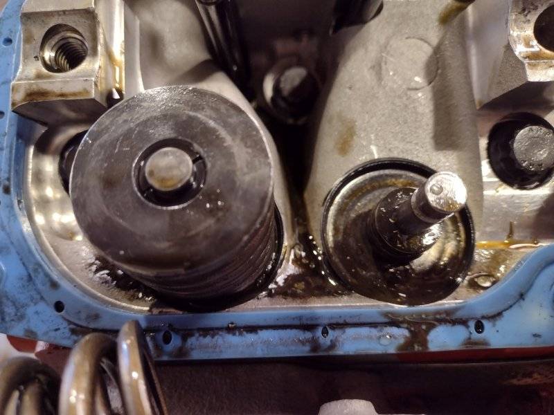

Also note a major factor in this failure was the retainer hitting the rocker. Hard to see here but the edges of the retainers where contact was made is present on most of them. She thinks the failure was her fault by taking it to 6000 RPM but it's not. A valve train that is substandard will become a secondary spring and tend to flex in unpredictable ways as RPM increases. Really bad things can happen at 6000 RPM and one must design accordingly.

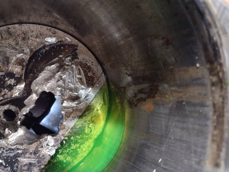

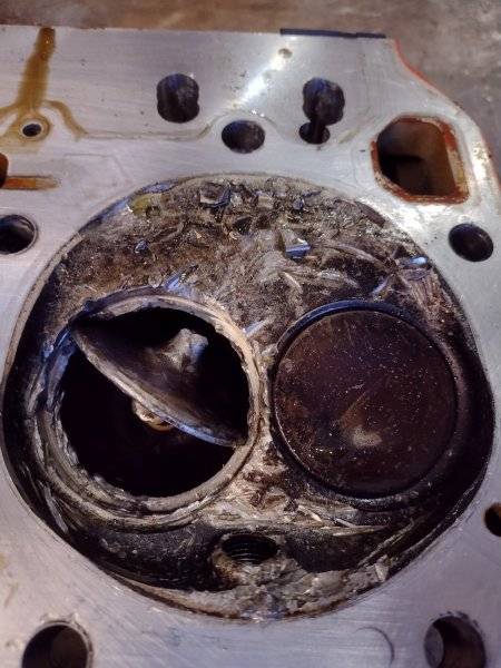

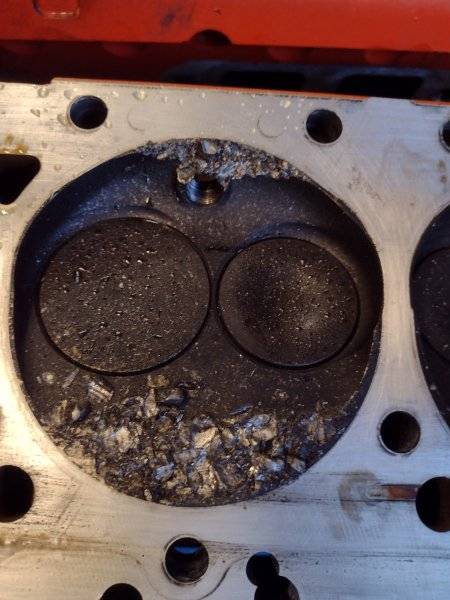

After pulling the heads the news only got worse. Crack in #8 cylinder, the intake valve seat from #8 found its way in three other cylinders. A small hole in #3 piston. Initially I thought the failure was caused by the high RPM and the retainer hitting the inside of the rocker, possibly dislodging the keeper. While that is not impossible, the failure may have originated by the intake seat falling out. Anyone have any similar experience with 440 Source heads? Seats falling out that is. I have no idea what cam is in it but it has dual springs and it's a hydraulic flat tappet.
It's now my task to bring this back to life and make sure it can handle 6000 RPM under the foot of this young lady, who also has a Porsche 911S turbo. When I suggested this may have a hot cam and I can tame it down she says "oh, I don't want to loose that." Haha! OK fine with me. This thing will be Brandi proof!

Yes the rockers do look original you can checkout my other post #12I’d say the use of what are probably 50+ year old rockers and shafts on a freshly built HP 440 combo was obviously a bad call.
The pic of the spacer in the wrong location in the pic in post #49 is evidence the assembler wasn’t very detail oriented and/or not very familiar Mopar big blocks.
There is only one reason new rockers weren’t used…….the cost would cut into the profits.

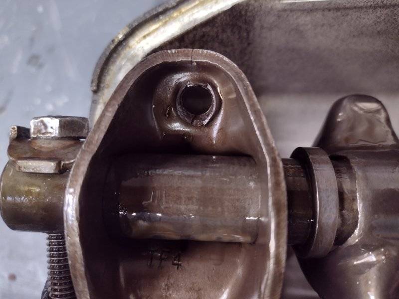

Heres an observation I find interesting…….
I’m assuming the rocker with the hole in it is off the cylinder with the broken intake valve.
Yet, that rocker would have been on the exhaust valve.
Looks like it to me too. They have the stock-looking casting on the end as Dwayne mentioned, plus in your pic you can see the shiny aluminum rocker pedestal.I agree it's a Stealth.

I've had pushrods punchYesterday a young lady brings me a hurt 440 out of her expensive 70 resto mod Charger that she recently purchased. The engine has under 400 miles and suffered some major damage because whoever built it missed the mark on the details. One clearly missed detail is a rocker arm spacer on the other bank was in the wrong position.
Yes but you'd think the dyno operator would warm up the engine properly, apply the full throttle carefully, monitor everything etc. The lady owner sounds like she's just getting in and riding that thing hard...and yes I am talking about the 440.As for the comments on 6000rpm and 400 miles…….
What do you guys think happens when a new engine goes on the dyno?
I can tell you for a fact…….there’s waaaay less than 400 miles worth of run time before going to WOT and max RPM.
If the failure was indeed RPM related, some parts used for the build weren’t suitable for that RPM……regardless of how long the break in period would have been.
