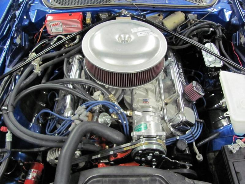

Pictured is a 440 that I just built for a friend. It is bored .030 with Diamond pistons, balanced steel/forged 3.75" crank, stock rods with ARP bolts, 6qt Hemi pan, Stealth heads with Comp springs, retainers and locks, (Had to machine heads to clearance pushrods), Smith Brother's custom length pushrods, Hughes roller rockers, RPM intake, Comp XE 230/236 hyd/flat tappet cam. This cam is quite noisy for a hydraulic cam and I guess it is the nature of the more aggressive ramps with less overall duration.
I think if I was to do this over, I would just get the Edelbrock heads and a bit larger solid cam, (240-248 duration @ .050" range), and if you had a few extra bucks I would use TTI headers over the Hedmans.
