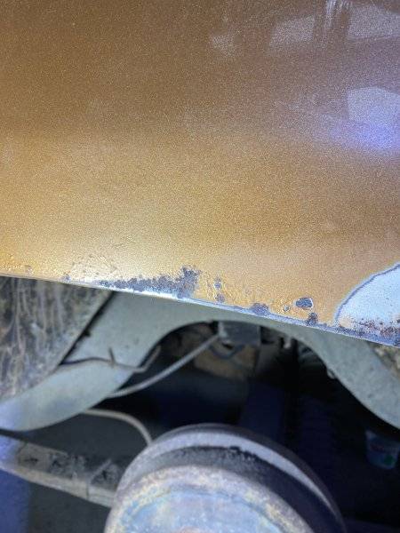

I had used baking soda in a sand blaster and it seemed to remove all the rust from within the pits leaving it cleaner than using the sand.
That’s a lot more than rust pits.Your latest photo says..... you need a 1/4 panel not a patch
Hello. If no holes best option is sand blast it should remove the rust in the pitting. Then epoxy primer(2-3)coats let harden a few days at that point scuff with 80grit paper and fill pits with a good quality body filler. Then prime and finish out as normal. Hope this helps.I’m starting to notice a few small rust pits as I am sanding the body. What are some options that have provided good results? I know sand blast would be the best but that isn’t very practical for my situation.
