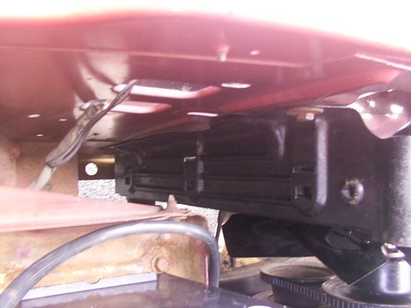

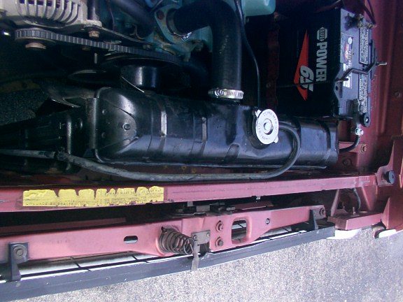

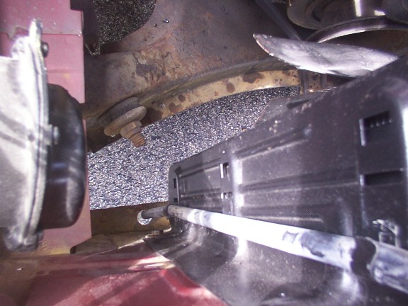

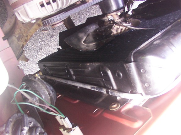

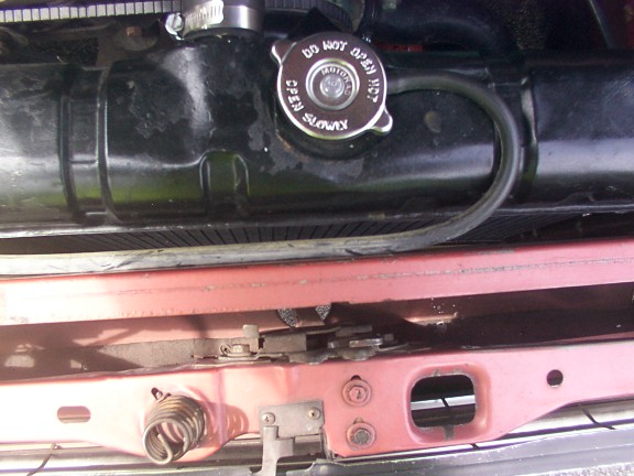

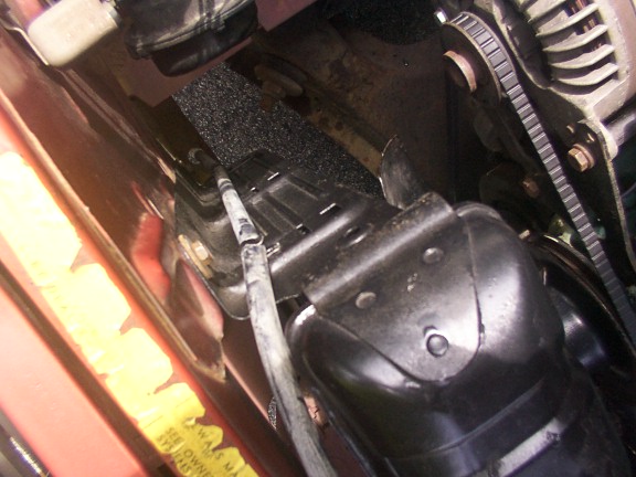

I'm going to try to attach some photos of the radiator to show the gap @ the top & what looks like a bracket to attach a shroud. it's a 1967 Plymouth Belvedere II. Thanks for your help. Ray
Looks about right. There should be brackets that fir into the holes on the sides, and the shroud attaches to those
Radiator looks correct. Double check the clutch on the fan to be sure its not wore out. Also lose the 160 stat for a 180 and be sure the radiator is flowing......
A fan shroud really should be used too.
Looks like the after market radiator I had. Had lots of problems with it. Ended up in the landfill.
you need a fan shroud. When your sitting in traffic, the air is not being directled on to the coils cooling them off. A lot of the cooling your getting now if from the air coming into the grill when your moving.
Check and test your anti-freeze also. When was it changed last, and how old is the radiator? It might just need rodded, which is not a big deal or expensive.
An old trick if it start getting hot is just turn on your heat. The heater core will also act like a radiator and cool your motor.
You might also need a higher flow Water pump.
Also looks like the extra one I have that functions perfectly.
