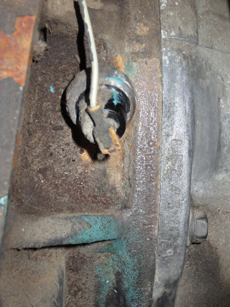

In 1968 your transmission should me stamped with the partial vin # at the top of the mounting flange, near the top of the engine, where the oil pressure switch is. Here is a pic of my numbers matching 68 GTS 383 727. The vin stamp for the engine should be opposite it as seen in the pic.

Thanks for your help. Is this picture taken from the underside? Or is taken from the back of the engine/firewall down??
that picture is looking down on the driver side. That number is the VIN#. As said earlier, look at the part number. You could have the correct transmission, but not the original to the car. The vin will show if it is original, the part number will clarify wether it is original to the make, model, and engine size.

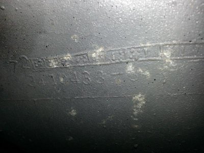

Found this series of numbers on the trans
trans.jpgnot sure what these numbers are. Any idea?? Appears to be 72 3410433-3
I checked a couple places for the stamp number you listed. Can't fin a transmission with that number from 1960-1981
Looking at your pic of numbers, paint between engine and tranny doesn't add up.. Something has been out of the car for sure.

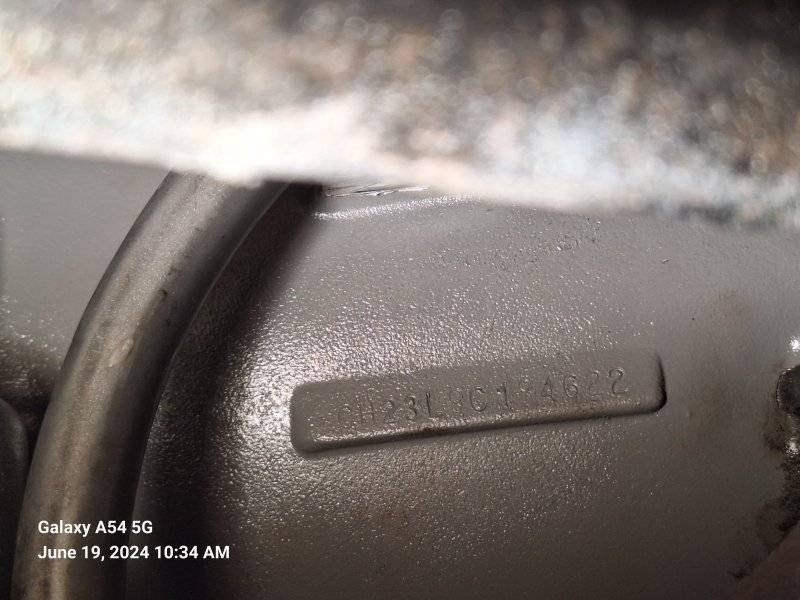

Mine is a 1968 Coronet 500. Here is the number I found on the 727. Help decode please.
