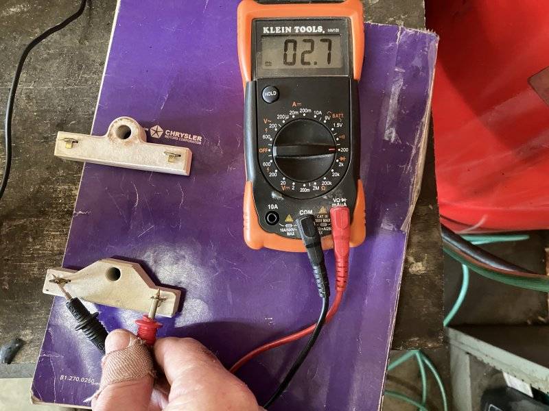

Today I bought a ballast resistor from the local NAPA store, a 2 pin unit like this one on the bottom:
That 2.7 number is unusually high. The new one is .8.
I took several ballast resistors and dunked them in a tank of Evaporust. All but 2 of them had corroded segments that I thought might have added to the resistance numbers. I'll clean, test and report the findings soon.

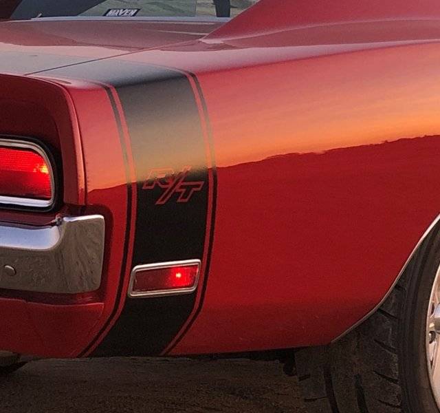

This EXACT thing has happened to me in this car:
...Numerous times. It is extremely frustrating. I've wondered if the parts just get hot, fail then once they cool down are fine again? That is hard to tell because sometimes I go for months with no issues at all, then the car cranks and cranks with no spark and I'm troubleshooting again.
Corrosion or build-up on the outside of a solid metallic object will not lessen or increase its resistance.
What WILL change the resistance is any build-up of foreign matter between the test-meter probes and the surface of the metallic object when measuring.
You could smother the ballast resistor in tar & feathers, and the resistance will not change.

Info like that HELPS. I appreciate the correction there. I obviously didn't know.
SEE ?
Info like that HELPS. I appreciate the help there. I obviously didn't know.
You just wasted your time with the Evaporust - unless you wanted it clean of course. :thumbsup:
Remember the other time that I did something stupid and pointless?
