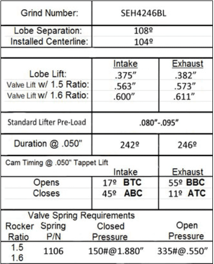

Looking to get a cam for my 500" Stroker build this winter. I have talked to Dave at Hughes and he spec'd out a cam for me that he said would run pretty well on the street with 3.91 gears and a 4 speed. See below:
My question is has anyone dealt with Engle cams? I called and talked to Chris who is super cool and seems great to deal with. He put me at a .534 lift hydraulic flat tappet with 238 duration @ .050 which seems pretty close to the Hughes. His cam is ground on a 110 or 112 degree centerline (really whatever centerline I want) to increase my idle quality and vacuum for power brakes. Does this seem feasible? What direction would you all recommend? I am thinking the Hughes cam may give me issues with the power brakes with low vacuum but wanna hear some opinions. How does everyone feel with the same lift and duration for intake and exhaust vs the different numbers from Hughes? Chris told me Mopar cams mostly work well with single pattern lift/duration vs the duals in most cases unless your trying for every extra HP you can grab. Thoughts?

Not according to Engle.....he said they haven't ground Hughes cams in quite a while due some riff with the Hughes guys. Guess they went separate ways a while back. Plus I am interested in any other info on the different lifts on the two and lobe angles.

I have adjustable rockers but I agree the Engle sounds like the way to go in that aspect. I like the sound of 108 degree centerline cams but the low vacuum for the brakes sucks. Engle said 110 or 112 would be much better.

Well, if you want to get into more depth (concerning possible drive ability) lets do this calculation. (Engle is example)
#1 - Intake Duration (add) Exhaust Duration (divide) by two = _______ (238 + 238 = 476 / 2 = 238)
#2 - LSA (multiply) by two = _____ (112 + 112 = 224)
Subtract #1 from #2 = ____ (238 - 224 = 14*)

Now, that gives us a better picture of the idle quality and drive-ability. Lots of popular camshafts here.

Engle = 14* overlap
Hughes = 28* overlap
Now, that gives us a better picture of how different both camshafts really are.

Engle K series cam lobes and Hughes cam lobes are good choices. Engle has lobes like the ones recommended by Dave (K-62/K-64 244°/249°) and Hughes has a cam like the ones Chris recommended (SEH3642BL 236°/242°). So the question is why did Dave and Chris spec different size cams considering that they have similar sized cam lobes available? I suspect that the answer is that they heard something a little different from you......even if you generally used the same words. So you need to get real clear and concise on what you want and then be able to articulate.
Here is my guess:
Dave heard 3.91 and 4 speed and said to himself that the 500 inch motor will want more cam and still be happy around town because of the gear and 4 speed.
Chris heard that you want a clean idle with good vacuum, so he went smaller.
My opinion is that hanging the exhaust valve open longer on a lower compression (Street car) is not that important. I suspect that most people on here would disagree.
Knowing more about the car's detail would be helpful. I generally lean toward smaller when it comes to cams, and a little small will always perform well, where as a little too big can be frustrating when a guy cares a lot about idle quality. But in this case, if it were me (and somehow I wanted a hydraulic cam), I would probably lean more to Dave's recommendation, but have it ground on at least a 110° LSA, or maybe 112°. Just add a little extra idle rpm if you're down a bit on vacuum.
If you plan to go to a 3.23, then maybe lean more to high 230s° on the intake on 110°.
Finally, I would also consider installing it with 0° or maybe 2° advanced.

BSB67 awesome info! Actually Dave also recommended the SEH3642BL cam as well as a smaller choice. He gave me two options. I see the smaller of the two is good at 3000RPM an the bigger is 3500RPM. I just don't want to overcam the engine and be disappointed. Idle I want choppy but I need vacuum for the brakes. That is what makes me lean towards the 238 duration with a 110 degree lobe separation. I have also been told to bump the cam up by a couple sizes with the stroker as it will eat up some duration. I basically want a nice sounding street engine that doesn't idle like an RV like mine does now. The cam is so small it has almost zero chop to it. As long as it makes vacuum for the brakes, the rest is easily manageable with the 4 speed and a 3.55 gear in the rear. I am leaning towards that K60 grind with a 110 lobe separation. The smaller ramps in Chris's cam with less lift will be a little more forgiving to my valvetrain. UNless you think the 244 degrees of duration will be eaten up with the stroker by that much? The car is all stock weight and has 10.75:1 compression with eddy rpm performer heads, performer rpm manifold, 850 quick fuel w/ mechanical secondaries, and a 440 source 500" stroker rotating assembly. I have a 28" tall rear tire on it, so with 3.55's it will be right about 3000RPM at 70MPH. I do have a 3.23 sure grip center section here that I could throw in, but I think that drops me out of the power band I want around town to have fun with.
