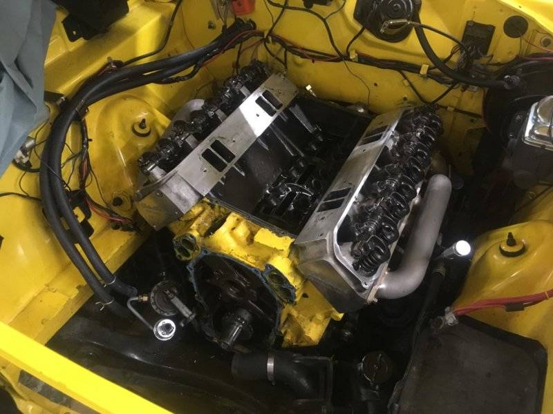

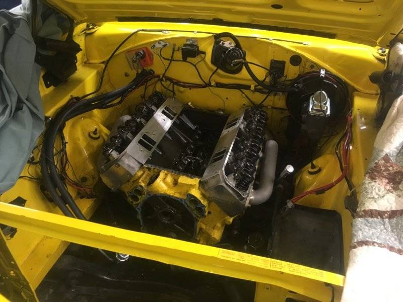

Ok boys prepare to laugh......so I yanked the cam out tonight of the motor and lone behold. I find an ISKY cam (ISKY 280 HL HYD 165128) that I have a cam card for that belongs in a small truck or RV. Duration @.050 is 224 degrees and the lift is .465 with a 108 degree lobe center. No wonder it idled smooth and died at 4000 RPM. That is close to a stock 383 cam from back in the day. What say you to that??? Hahaha what a joke I almost laughed when I read the data on it. What a relief knowing why the motor was a slouch and had a shitty lame idle.
