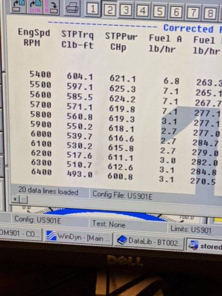

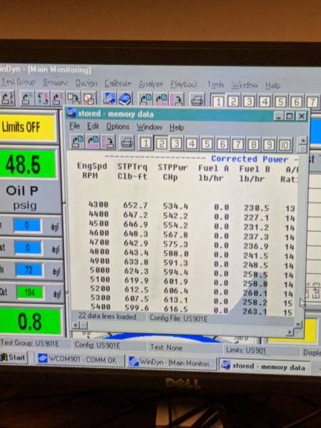

Car should trap around 6000 + converter slip. It will have a 6al-2 so i'll set the limiter only as high as i feel it needs ,no point in buzzing it too high,too many times. No matter what happens ,i will post dyno results .From what I'm reading here we are safe from 5800 till 6300. If you are all in at 6200 and your torque and hp stay on the good side then no problem. 6300 up sounds like it could be trouble so if we only bump the top number now and then should be ok.

No plans on NO2 for me.I don't remember but did anyone answer your question that is running juice. With the juice added rpms must jump up pretty quick. So what do they use.

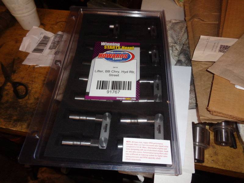

493 Ohio 4.150 crank, Eagle h beams, icon pistons for 10:1 pump gas ,wanted it be able to run on 91 if that's all that was available ( currently run 93 ). Trick Flow 270's , Indy dual plane d.p.m.to the 270's ,Brawler 950 for now, 250/258 Erson hydr. roller 550 lift ,110 ,1.6 Harland Sharp for close to 600 lift , Howards lifters #91774 ( really Gatormans i'm told) .Cvf Wraptor Black Diamond serpentine ac/ps. Car is a 64' Polara , all steel, full interior, street car, mini tubbed, us car tool level 3, dana 60 , RMS Alterkation front set up. So far it's turning out to be a really fun project , learning a lot from this forum.Great numbers! What was the combo?
Thanks for posting.493 Ohio 4.150 crank, Eagle h beams, icon pistons for 10:1 pump gas ,wanted it be able to run on 91 if that's all that was available ( currently run 93 ). Trick Flow 270's , Indy dual plane d.p.m.to the 270's ,Brawler 950 for now, 250/258 Erson hydr. roller 550 lift ,110 ,1.6 Harland Sharp for close to 600 lift , Howards lifters #91774 ( really Gatormans i'm told) .Cvf Wraptor Black Diamond serpentine ac/ps. Car is a 64' Polara , all steel, full interior, street car, mini tubbed, us car tool level 3, dana 60 , RMS Alterkation front set up. So far it's turning out to be a really fun project , learning a lot from this forum.
