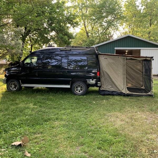

I never actually had the awnings and tent rooms up, so needed to see what that's about.

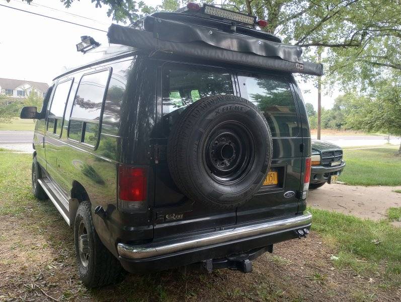

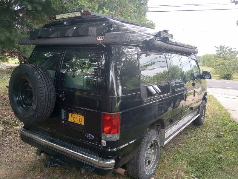

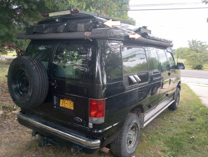

also installed a 17 gallon fuel cell where the spare tire used to live. I got a modern filler neck out of a junkyard wreck and modified it to work; and put a locking cap on it, you can see in the pic. I hooked it to a 12 volt pump and ran a line to the filler neck area. I had to run a vent tube up through the rear corner and out the roof......... fuel is easily transferred into the van fuel tank or into the portable generator. We estimate the van has approximately 500 mile range
the rubber flaps keep water from running between the van and the tents, 3 inch pvc tubes hold fishing rods, but also serve as a mounting surface for the rubber

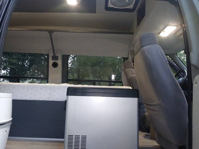

the exhaust fan is set to open at 78* and close if it rains....... the refrigerator will actually freeze things if set low enough .......both have been working flawlessly and uninterrupted for months
when armed, the security lights come on and blind anything within 40 feet
I see me rocking this beast at Carlisle next year :bananadance:
I will black out the rest of the exterior next time I have it, just ran out of time
and nothing says mobile meth lab like a dryer vent hanging out the side :lol:
one dryer vent is exhaust for the air conditioner, the other vent is for running electric into said air conditioner; either from the generator or an outside source

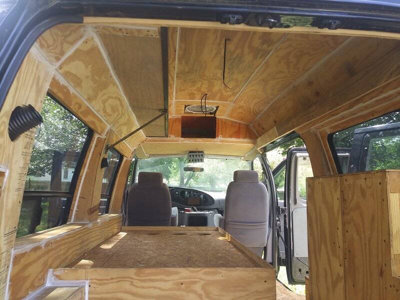

never backing down from a challenge, I said "Hold my beer" ...... and proceeded to gut what was there
and then it snowballed........... and over the next 20 months, I proceeded to stuff 20 pounds of goodies into a 2 pound box

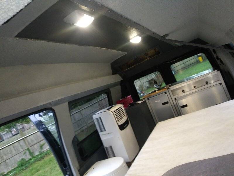

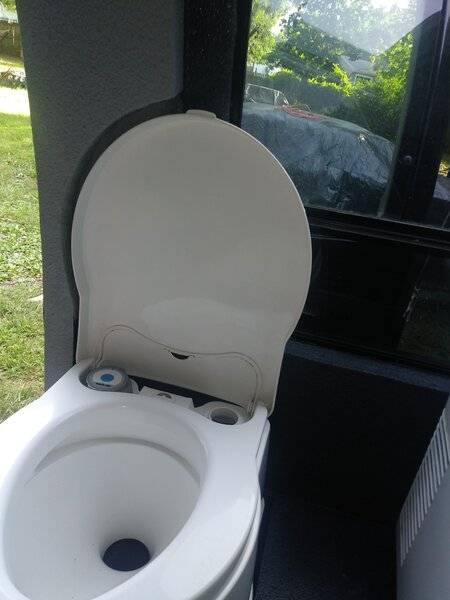

on demand hot water for a shower
a portable chemical toilet
sink and 2 burner stove combo
45 gallon water tank supply under the bed
AC powered air conditioner, and portable gas generator
portable awnings and tent room rear and side
roof exhaust fan
refrigerator
exterior lighting
reverse camera
big *** deep cycle DC batteries power all the accessories
AC power inverter
200 watt solar panel charges the batteries
i may have forgotten something
it kicked my ***...... but eventually, I came out on top

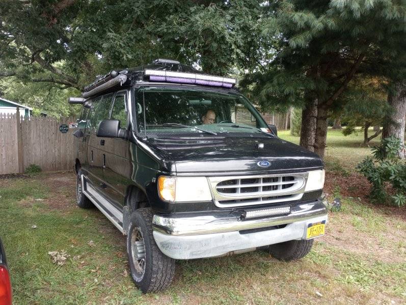

I might have missed it somewhere, but what engine is in it? I was assuming it was a diesel to go with the off the grid idea since they run on nearly anything.
gas.....diesel would be awesome

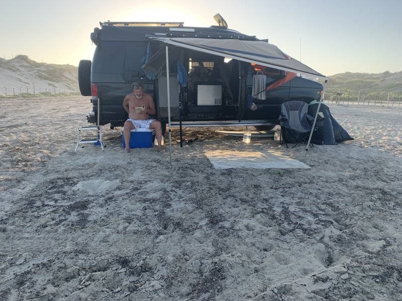

my van made it to the tip of Baja without a hitch, and everything is functioning as designed.......
my Brother sent me a couple pics today, I knew he was headed out, but I didn't know he had already left.......
I broke my nuts building that monstrosity, the one pic put a huge grin on my face

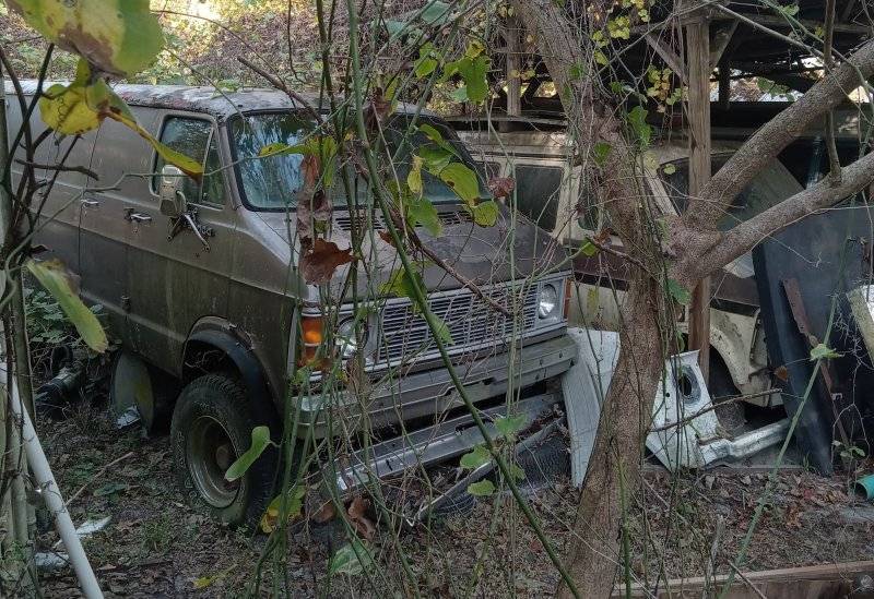

Dodge pathfinder 4x4 and a Dodge turtle top camper van. Will morph them together to have a 4x4 turtle top camper van. Pardon my jungle.
