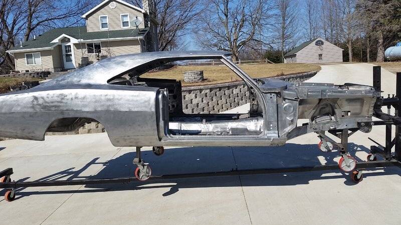

I CHEATED! How I stripped my 69 Charger deck lid.

I'm going to take the shell to them when the time comes. I think this is better than getting it blasted, what do you think?

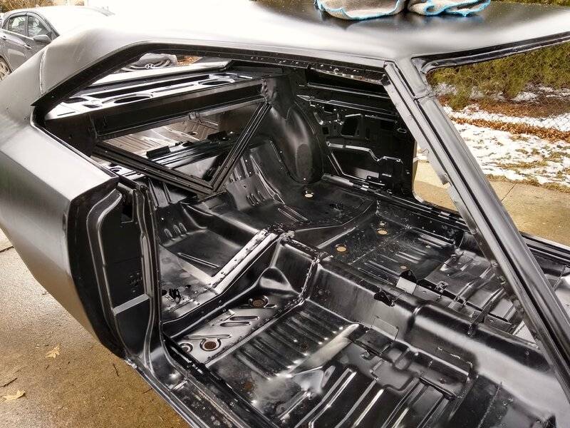

WOW! THAT'S AWESOME! (At the risk of overusing that word!) What show were you at? Did you do the work or had it done at a shop?

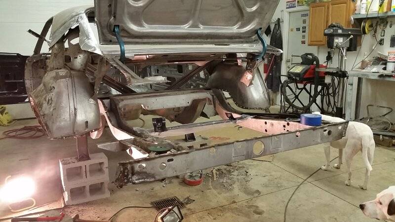

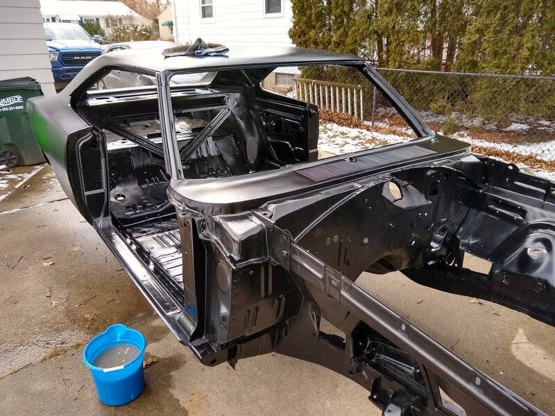

It was debuted at autorama in detroit this year before the obvious, i did the metal work had some body work done to it wasn't impressed ended up doing most of it had a friend tweak out some waves in the rear quarters and he shot it in his paint booth. i assembled and rebuilt the rest of the car. it was a tedious task but have to say it was well worth it. Met many cool people along the way. the akaline dip was a kick *** thing to have done, made it easy to work on, make sure you get all the dried debrie out of it. i put mine on a rotiserrie and you could hear the **** rolling around inside at the sandwich points of the metals, it was like the stuff on a corroded battery, I'm sure with a little moisture could cause
some bad issues, like where the rear quarters tie into trunk extentions. I had that car dipped in electrocoat primer in a tank by ft. wayne indiana, car was submergered with current through the body, will never rust. the rest is in my build thread shows most of the process.
Did you lead the C pillar? That's what I'm planning on doing from now on. Where did you get your dolly or did you make it?

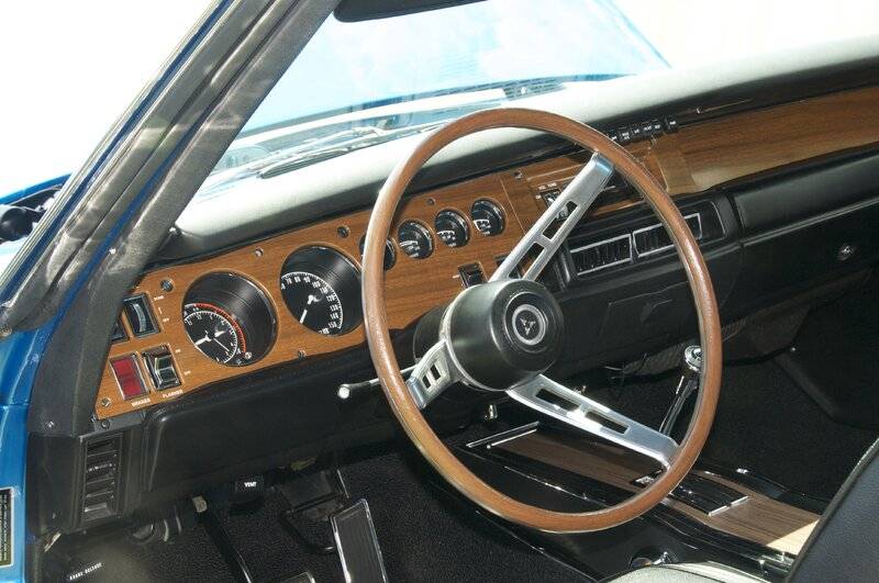

Fantastic steering wheel restoration by Glaser Restorations. I've had a number of people ask about who did it and how good it looks. You be the judge! (I did the horn button)
Did you forget to post something or did it malfunction?:lol:
That's really weird. A malfunction. My cellphone has been doing odd things today. Gremlins.

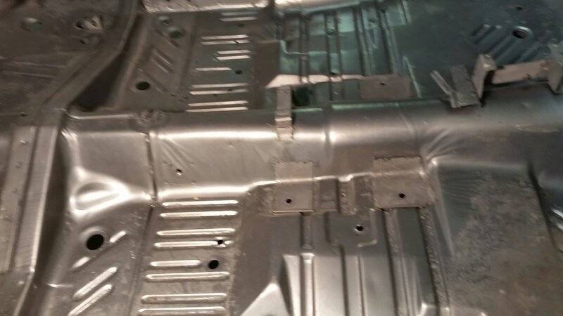

Does that dip process remove the dum-dum between the panels that prevent drumming, and can you get in there to replace it?
Nice job by the way!
Yes, it removes it and the restoration guy says it can be inserted by drilling a small hole and applying it then epoxy the hole closed.

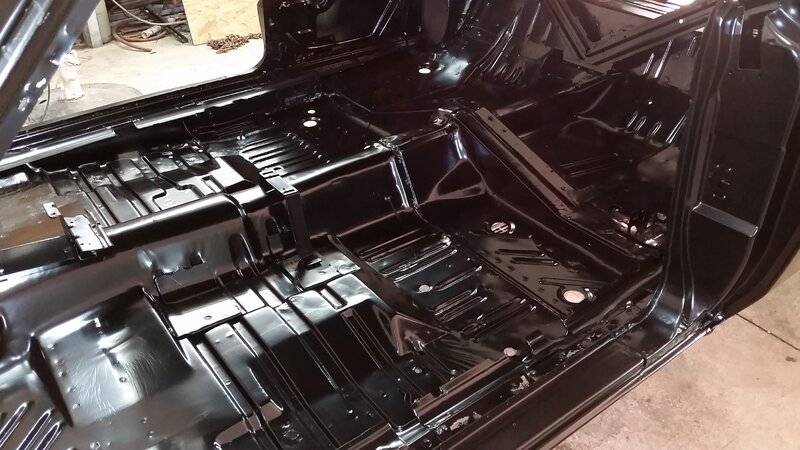

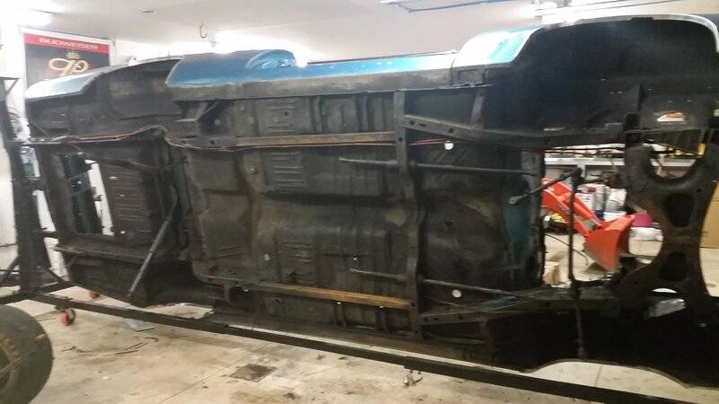

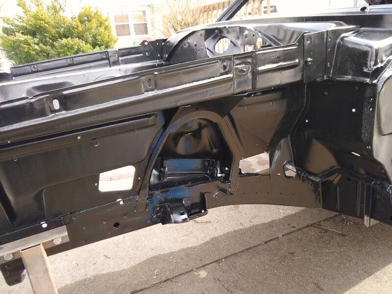

Stripping and e coating is definitely the way to go. I just had the process done on my '68 shell a couple of months back. I'm extremely happy with it:

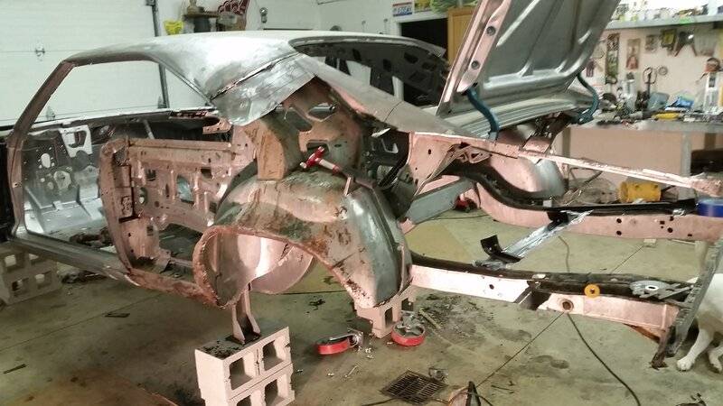

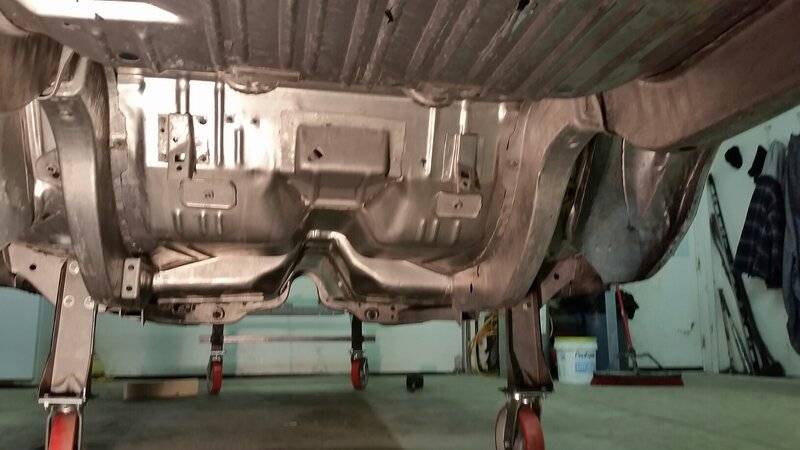

It was debuted at autorama in detroit this year before the obvious, i did the metal work had some body work done to it wasn't impressed ended up doing most of it had a friend tweak out some waves in the rear quarters and he shot it in his paint booth. i assembled and rebuilt the rest of the car. it was a tedious task but have to say it was well worth it. Met many cool people along the way. the akaline dip was a kick *** thing to have done, made it easy to work on, make sure you get all the dried debrie out of it. i put mine on a rotiserrie and you could hear the **** rolling around inside at the sandwich points of the metals, it was like the stuff on a corroded battery, I'm sure with a little moisture could causeView attachment 951138 View attachment 951139 View attachment 951140 View attachment 951141 View attachment 951142 View attachment 951143 View attachment 951144 View attachment 951145 some bad issues, like where the rear quarters tie into trunk extentions. I had that car dipped in electrocoat primer in a tank by ft. wayne indiana, car was submergered with current through the body, will never rust. the rest is in my build thread shows most of the process.
I had my last car sand blasted - that was the decision of the shop and I really didn't know any better. I had it on a rack and was cleaning the undercarriage and noticed sand coming out of the holes in the frame rails. I started digging it out and there was pounds of stuff in there. Pissed me off. The car is usually trailered and I do drive it but even with careful planning I've been caught in the rain. How long will it take to be a problem? I don't know. Thanks for posting the photos. I'll go look at your thread.
That looks great! Where did you have that done? Are you going to lead the C pillar?
They e coated my car at AMD Installations but would do it this way next time.
Thanks! I had it done up in Detroit at a place called International Paint Stripping. As for the lead seams, I'm not sure yet. I've been contemplating everything from lead to All Metal to panel bond.
Not familiar with All Metal, just had a lot of old school guys say that using lead is the way to go. Definitely not using panel bond - it's good stuff but if I can choose, I'll do lead. I hope I can find some place closer but Detroit isn't a bad drive.
Can I ask what it cost for the e coating? How long did it take for them to turn it around?

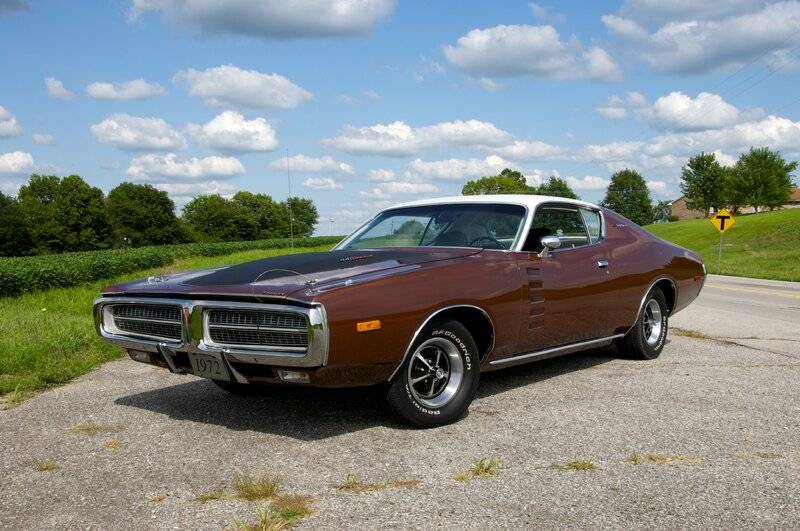

Thats one gorgeous 72 you have. :thumbsup:
That was my first classic - saw the photos in the listing and was pretty much in love, then really fell for it when I saw it. When I first started taking it to shows it was pretty much overlooked. Then lately, it seems that the judges have been Mopar guys and actually know what it is. These cars are like my children and I am passionate about taking care of them. This Charger is different from the 2nd gen cars that are temperamental; they may let you drive them or they decide they don't want to do anything. This '72 says: let me carry you. It loves to drive and cold weather doesn't bother it at all.
Do you have photos of your car you can post? I'd love to see them!
Here ya go...
