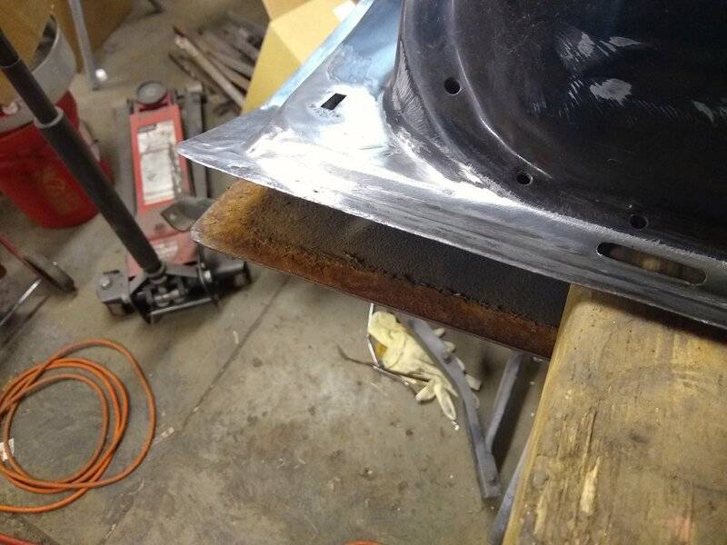

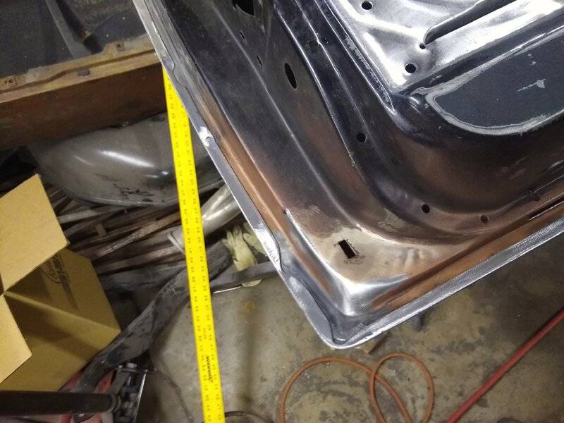

i ended up not doing any of the other panels. I bought a new trunk lid so it’s already e coated and the doors I actually separated the skins from the shells and cleaned out all of the rust then I epoxy primed everything and reassembled. I’m doing a similar process with the fenders as well.

How did you clean out the rust?

I totally removed the inside lips of the doors and cleaned up the area in between the lip and shell, then with the skin being loose I cleaned up in between the outer side of the shell and door skin. I did this with a combination of fiber wheels and wire wheels. Then I coated the areas in-between with Eastwood rust converter. I made new inner lips for the insides of the doors, sprayed all of the areas with weld through primer and welded the lips back on. Once I'm done with final gapping of the doors I'm going to pour rust encapsulator down in the seams from the inside just to seal everything up
