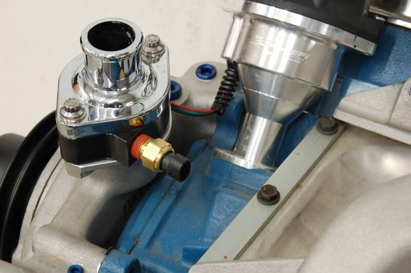

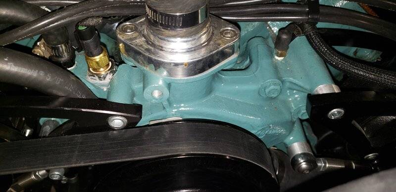

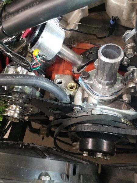

My biggest worry about doing that was finding a thick enough spot to drill into to get enough threads on it. Was it leaking at the o-ring? I also raised the housing nipple up , used the old housing as a base by cutting the neck off. So it's pump, thermostat, o-ringed old housing (minus neck), gasket and sealant, new housing. That was my fear that it would leak, I'll see I guess! Thanks for the heads up.I've got one of these that I was putting on the 69 Ply wagon I am building for a guy and to be honest, I am not happy with it. I do not at all like the O ring on the one side. I ended up just drilling a new hole for a water temp probe and reinstalled the thermostat housing.
To be honest I never pressurized the system with it, I didn't (don't) trust it. I drilled the hole to the right of the Tstat housing after watching an episode of junkerup on YouTube where Chris did it. We have a 440 Source WP housing and its definitely thick enough.
So you trust a paper based gasket but you don't trust an O ring??? Okay....
That is correct, that O ring is pretty thin.

I can't really tell from the picture but it looks like the port is in the water neck? If so that won't work. The port needs to be below the thermostat or else it won't work.Found a long thermostat housing with the 3/8" port. There are a lot more options out there than I thought. Thanks for the help all.
I drilled a pee hole in the thermostat .I can't really tell from the picture but it looks like the port is in the water neck? If so that won't work. The port needs to be below the thermostat or else it won't work.
