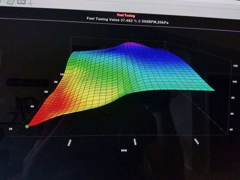

Here is a fuel graph after adding learn table and some smoothing.

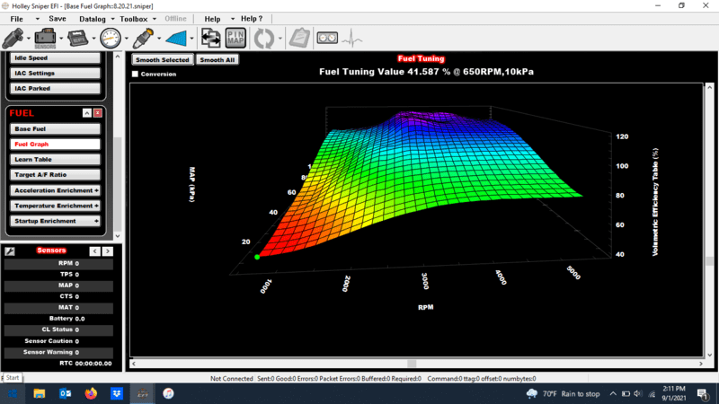

So, my fuel graph looks fairly similar to yours.
It's taken me a while to get to this point but I'm finally understanding what needs to happen with this Sniper thing. Building a config file was what really got me to this point and how it all started coming together. You really do have to put the time into it.
Looking at your fuel graph from way back in January, it looks like we both have a similar spot around 3,500 rpm and little vacuum. I have a theory about it because it's been difficult to tune it out. Since mine is a 4 speed, I believe it's from winding the car out in gear and then letting off the gas to shift. (no, I'm not power shifting) The inertia of the flywheel keeps the engine at close to where the rpm was when you let off the pedal so it's seeing 3,500 but since your foot comes off the throttle there is no TPS input at that instant and the ECU adds fuel to compensate to be safe. Not sure if there is anything I can do about it unless I do start power shifting!

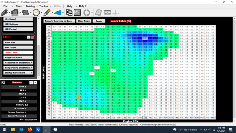

My learn table is pretty decent right now except for that blue spot which is the same as the purple area in the fuel graph. Might be able to reduce the compensation values soon.
