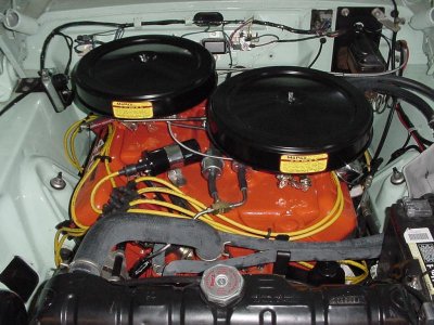

if that car drives as good as it looks, you've got a real sweetheart!
Wow, that is one nice exposed under hood. Guys, I think I will find a nice ... or nicer day and begin peeling her apart. I do need to basically start from scratch and know what I have got. They rolled off of the assembly line running, so mine should. She was built to sell at Barrett Jackson, and did. Thing about it is, she has never run. Down she comes and I will let you know in time what she has in her. I may need to go back with fat head gaskets to lessen the comp. Thanks for the motivation to know that surgery is needed. I'll get back to you.

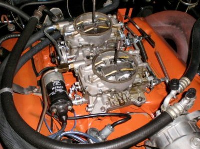

Something else that crossed my mind is that the passenger side manifold has burned the paint off of the valve cover where they are so close anyway. A harley I had use to have issues with heat if it was running too lean. Could this be something that I might get schooled in metering rods for these carter AFB / Edelbrock carbs and try another size rods in them first? The plugs are kind of grey now.
look for a number on your carbs to find out what they are. from there you can find out what they're suppose to have in them. compare that to what rods and jets are in the carbs now. this will give you a baseline to go from.
ILM65; Wow, nice engine compartment! Plymouth, MI? Really? How cool is that.
71RR; If you Google "Tuning AFB carbs" you'll come up with a wealth of knowledge about rods, jets, float levels, etc. for the carbs you have. The numbers are stamped on the front base of the carb, usually 4 numbers and a letter. Particularly helpful is the "Carter AFB selection and tuning guidelines" by Federal Mogul Tech Education Center. Yes, running lean can cause too much heat in the exhaust, but so can being too far retarded and an assortment of other things. Take a few pictures of the top of the motor without air cleaners as well as the base of the carbs.

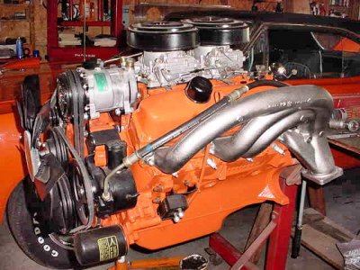

My Max Wedge copy is a street car. Other than it's a little cold-blooded until it gets warmed up, it's fine. No coughing or sputtering. 300 degree .528 lift cam. 10.5 compression.

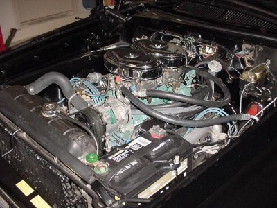

This is my other 2X 4 car. Again, no coughing or sputtering. It ran decent with the carbs out of the box before I tuned them. Most likely you have some other problems. It runs well at idle even in hot weather with the a/c on.
