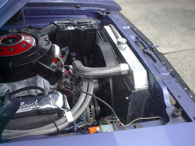

I just bought a 3 row aluminum radiator ( champion ). I had to do a little modifying on mine because I had to buy one using dimensions instead of getting one for my 67 coronet. Reason being it had a small block in it. Now it has a 440. The radiator someone put in during the swap came from a 68 C body. It looks great and flows good. It even came with an electric fan.

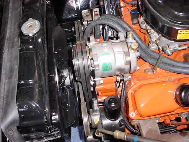

.030 440,old purple shaft cam,10.01 actual compression ratio.O.E.M. 22" 3 core radiator,6 blade a/c pump,180* thermostat ,fixed 7 blade fan with shroud.Has never seen anything above 195*,and it even has A/C !!With the correct components working right you don't need aluminum radiators and electric fan's !!
