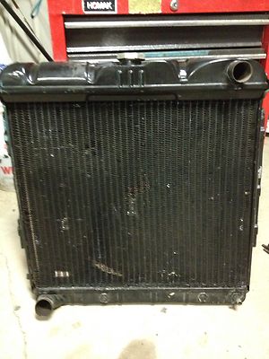

I have this radiator for sale. Not sure if it will be fit but looks similar. I never used it cuz it wouldn't fit my 318 setup.
$100 plus ride. Suppose to have been re-cored prior to me getting it.
2524984 1965 C-Body RADIATOR 22" 383 BOTH HI ALT-A/C Dodge Plymouth Chrysler
