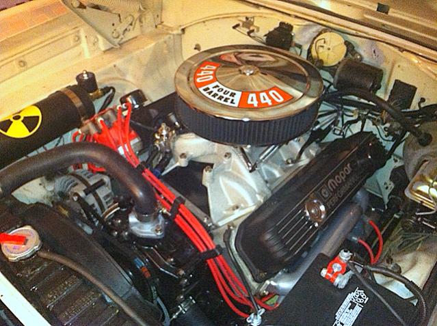

Tti the way to go ,second pair . I got mine through cppa chrysler power magazine . They offer a discount if you join up as a platinum member its $99 bucks you get a 10% discount on tti product as well as a bunch of other products. You get a magazine subscription, cppa t-shirt ,news letters, tti discount , discount on parts from herbs parts ... The discount alone on a set of headers alone pays for the membership fee NEW AIRCLEANER.jpgPicture 369.jpg
