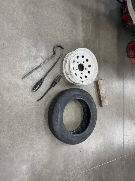

Busting some tires off the trailer wheels tonight and I couldn’t help but think of how nice it would be to be using a tire machine.
Never had one. Maybe will one day. Had to be innovative to bust those beads.

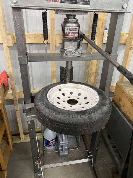

When i was younger we would use a bumper jack on a car, the bumper jack foot slides perfect inbetween the rim/tire
If you've got a heavy truck, just place a 4x4 on the sidewalk and drive up on it.
I don't like doing that with steel belted radials....but used a bare rim on a vehicle up on a jack then let it down where the edge of the rim contacted the bead and that usually worked. Finally got a manual tire machine and things became much easier but dumb *** me sold it when the X left thinking living here wasn't going to be happening for long. I'm still here minus a tire machine and lots of other stuff.
