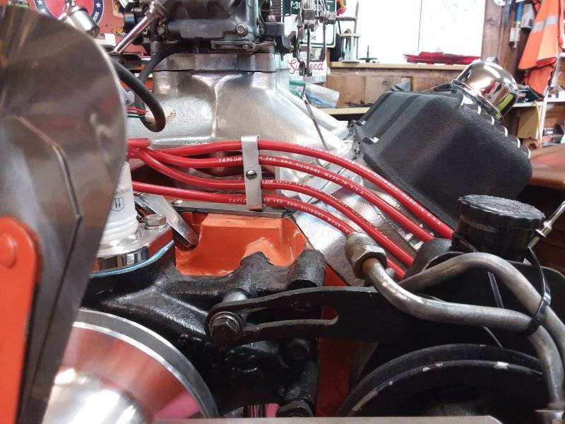

Taylor Spiro Pro 8mm.

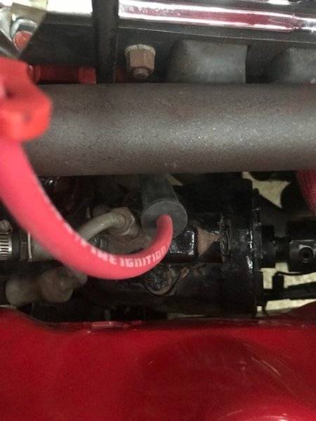

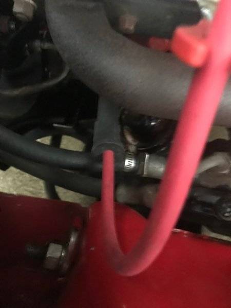

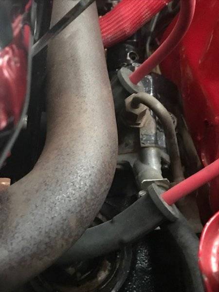

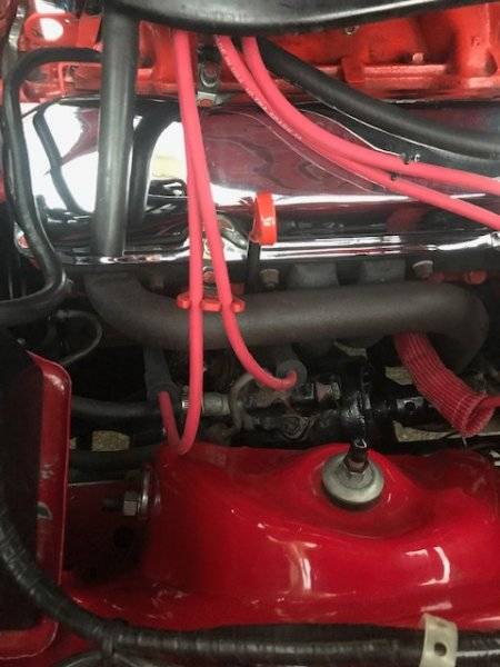

Show us a couple of pictures of your existing wire set up and we can make better suggestions. I run an old set of ACCELs that I have adapted with different boots over the years.
Ok, I'll take some pics later and post em here.

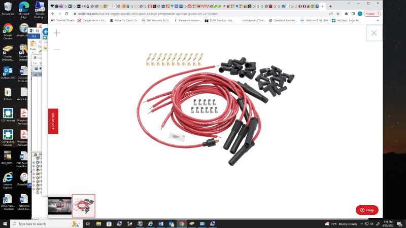

BTW-These are the wires I have, the extra long plug boots causes the problem.

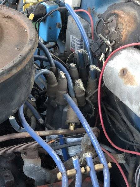

I wouldn’t get the blue Mopar Performance 8mm ones. Some kind of a rodent ate mine. :(
