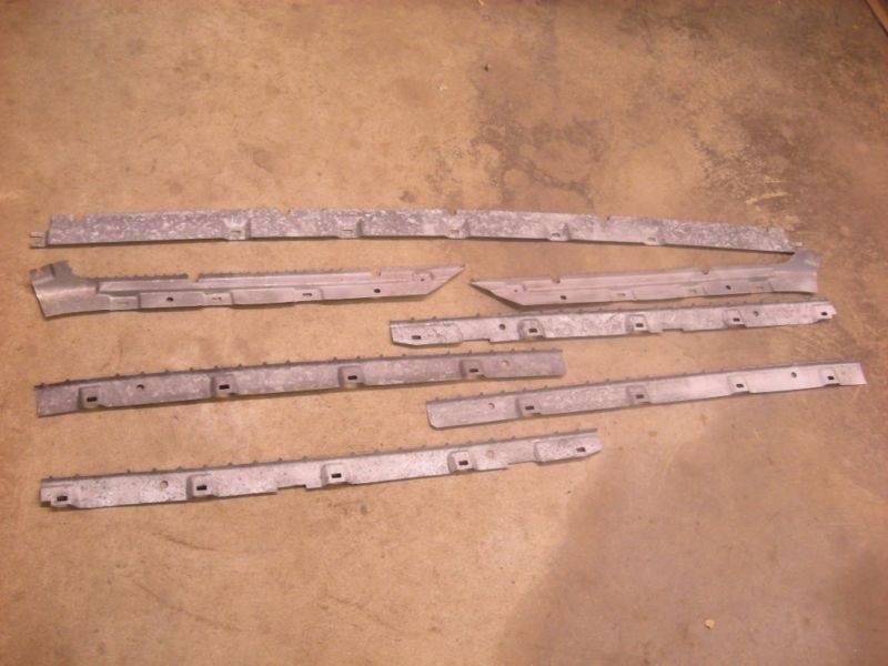

My 67 GTX is in pieces now but if I remember right from disassembly the interior trim screws screw into the slotted holes in the headliner retainers pictured below and the headliner bow retainer clips slip over the flat angled surfaces in headliner retainers...
Howdy Joe, I installed those moldings about 18 months ago, my memory is a little fuzzy. The headliner retainer brackets that Cmmopar is showing in his photo, I believe are held in by little pinch clips. This clip is a 1966 version of a modern 2 legged push retainer. If I remember correctly the clips go through the retainer and are "pinched" to expand the tabs into the B.I.W. I don't think that trim moldings screw to the headliner retainer brackets. I believe the screw locations for the moldings are not holes but slots in the B.I.W. (in the roof side rail). If you look carefully you will be able to see where the screw was in the slot. I hope that this helps! Brian.

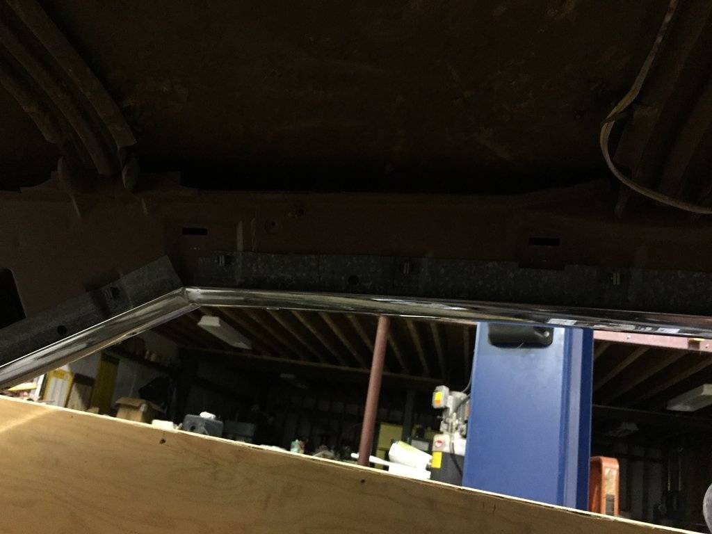

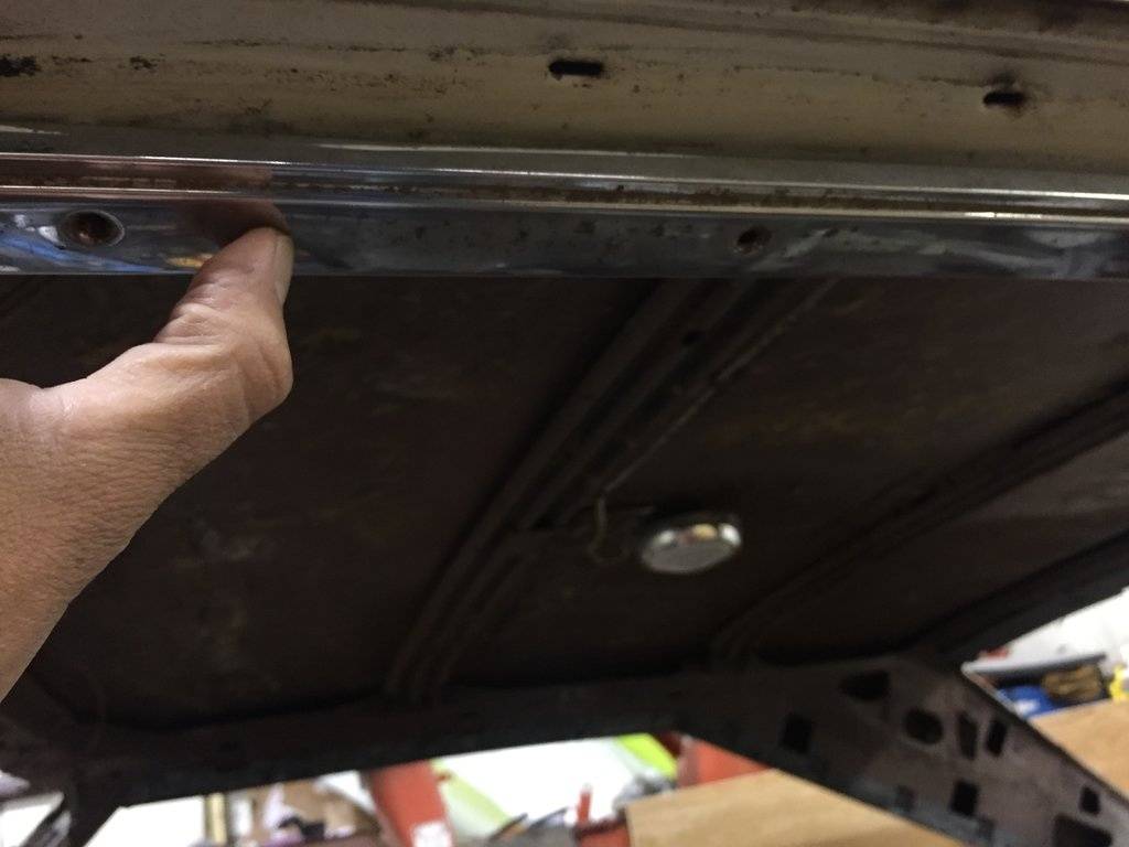

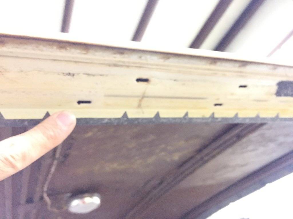

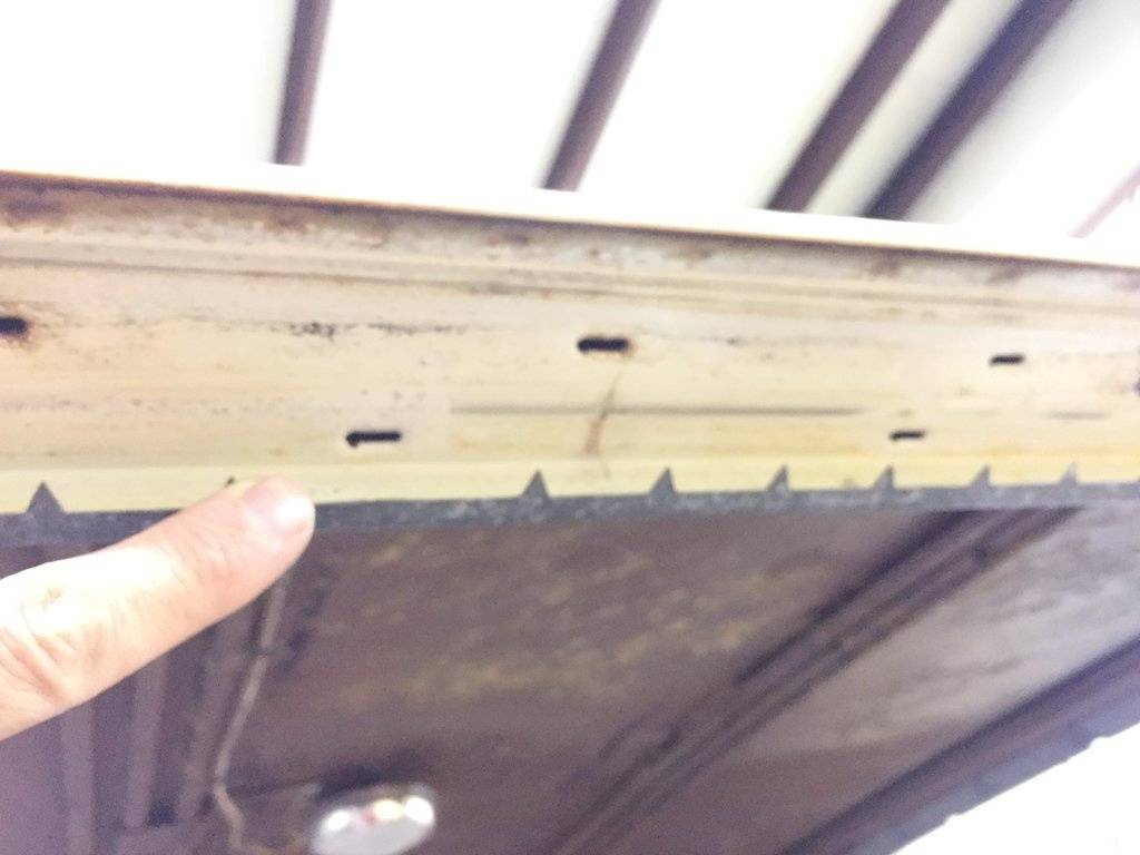

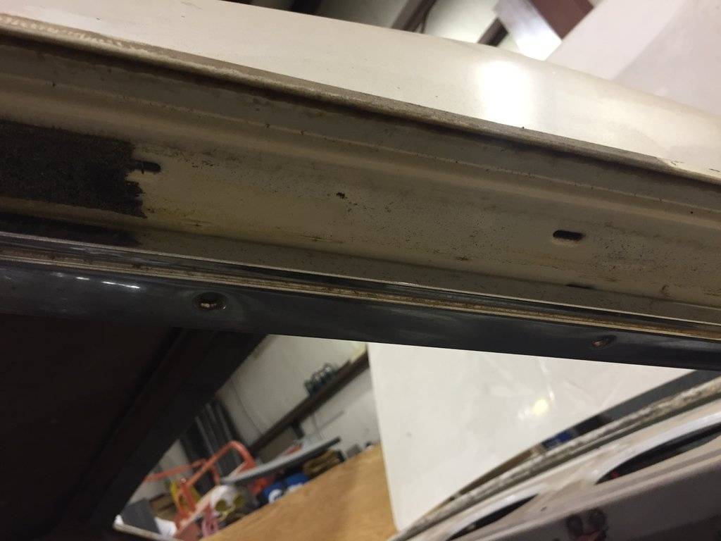

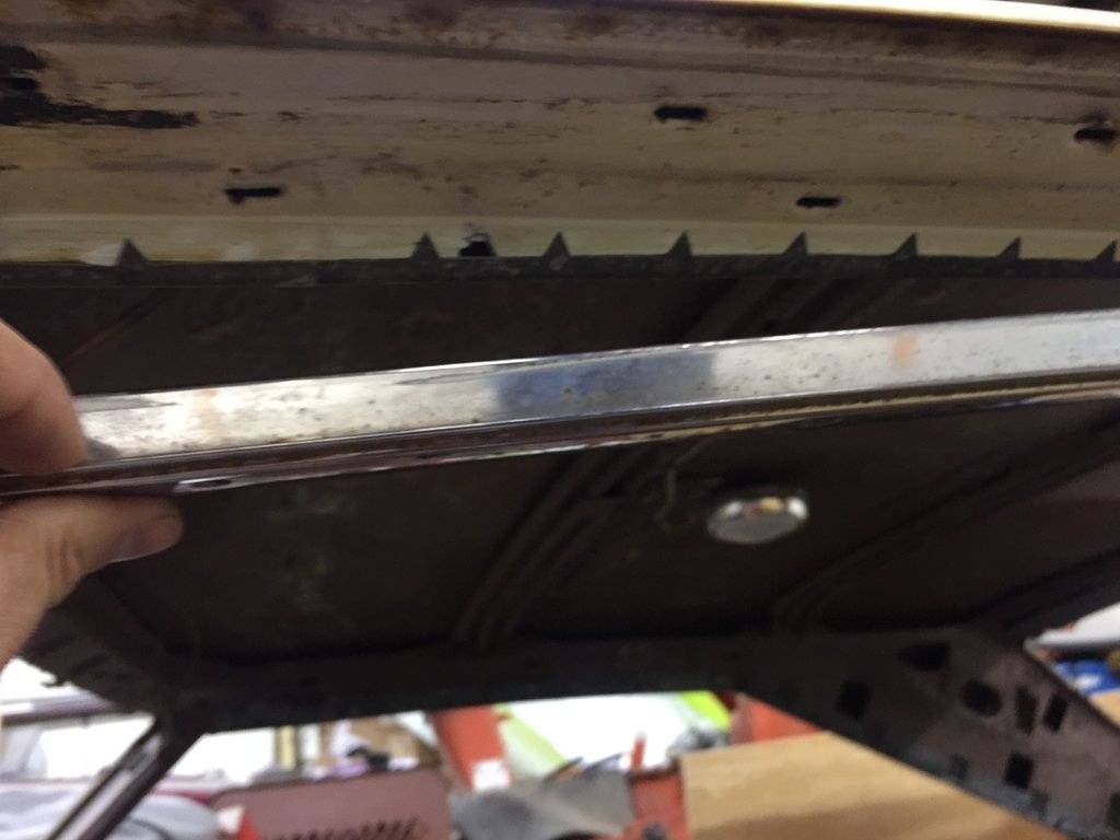

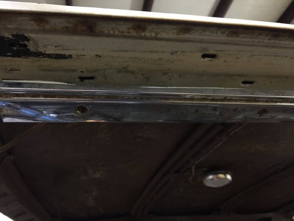

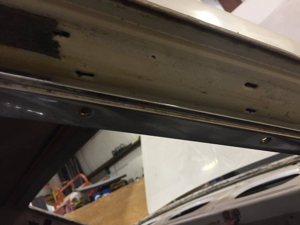

Finally was able to get to car to get pics. Trim attaches by long screws directly into innermost slots in upper door opening right above headliner retainer teeth. I am pointing to it one of the pics. If you need more pics let me know...
IMG_2570.JPG IMG_2571.JPG IMG_2572.JPG IMG_2573.JPG IMG_2574.JPG IMG_2575.JPG IMG_2576.JPG IMG_2577.JPG
View attachment 511414 View attachment 511415 View attachment 511416 View attachment 511417 View attachment 511418 View attachment 511419 View attachment 511420 View attachment 511421
Thank you very much, so I guess my material was hiding those slots. I think I can finally put this thing together! I still owe some photos I will post some. My 66 is still more coal then diamond but it is getting there.
