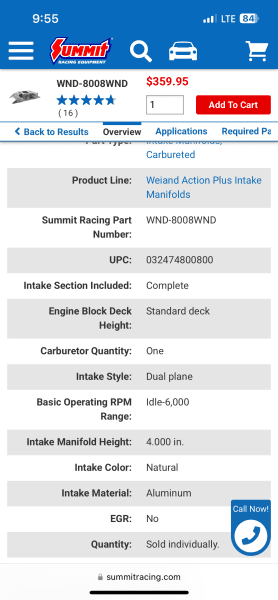

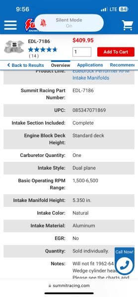

Currently have a 383 with a Weiand 8008 intake and want to move to an Eddy RPM.
I don't have a lot of hood clearance and was wondering if anyone knew how much taller the Eddy Intake carb mount surface is over the 8008.
According to Summit racing the Weiand is 4.00”, RPM is 5.350”
