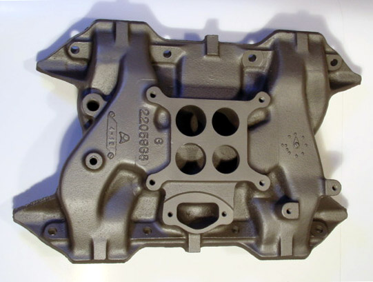

Take a look at this 383 Intake Manifold {1962 thru 1967} Casting #2205968
Massive Heat Cross-Over Passages
Gpuller......you're killing me! LOL!!! I have had entirely too many days suffering from those ole "Holley blues" trying to get them to adapt to the constantly evolving Oklahoma weather. Ain't nobody got time for all that! If this was a four speed, I would consider a Braswell double pumper or something, but it isn't. Those 3310s are aggravating as hell even when they are working "good enough".
I verified my P/N on the intake and it absolutely is that 2205968. I don't think I can use my A/C brackets on any other intake though. The way they run over the intake runners kinda limits me. I am 95% certain they won't fit with the Performer that I have. As I said earlier, this 2186 has open crossovers as well, so swapping to it may not achieve much more than elevating the carb more. Aluminum might gain me a bit more in temp reduction, but I am feeling that blocking those ports is key. It HAS to help!
