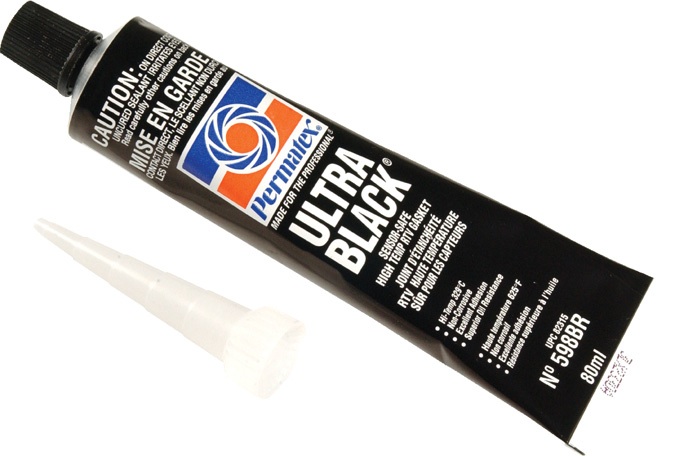

This time I just use black RTV on both sides of the bathtub (paper gaskets to tub) then install, no sealant on the heads or the manifold. let the bathtub do the work as the ridges on it will crush and create a seal. with the paper gaskets installed it will help the seal around the ports and for fuel & vacuum so I'm told. Will let you know tomorrow how it works out, But just like valve covers, just seal the gasket to the cover then after a few minutes of letting it get tacky then install no goop on the head.
Front and rear hold down bars hold down the front & rear of the bathtub use RTV under them bolt down, take care to get RTV in the corners where the bar meets the manifold, the only leak spot on these.

Thank you for the advice. Im gonna pick up some black Rtv on monday. I ll see if my local parts store has those gaskets and a new valley pan

Any of these better for sealing the valley pan to the block and intake. No paper gaskets. Engine buildwr didnt use any
I just got done using the bathtube with paper gaskets on either side of the tub, pipe dope for the bolt threads and black RTV on the hold down areas with a little extra in the corners and less than an hour setup time and fired it all up and no leaks. Just an FYI

you're probably right, I am trying the paper gaskets now and they work fine but my set up as you know is not stock just keeping with the peace of mind idea of no vac leaks anywhere plus I am using stainless steel ARP manifold bolts. one thing I did learn is to use thread sealant not the ARP stuff on manifold bolts, as oil will find that tiny little gap in the threads and weep it's way up and out on to the bathtub. The ARP thread lube gets thin and may hold threads in place but does not seal.
Last round I used just the bathtub with aviation sealant and that worked however I will never use he aviation stuff again as it never really got solid and ended up leaking into the valley itself. when the motor was hot you could see and feel that stuff like goop made a more of a mess than just RTV. I'm told you don't even need RTV at all except maybe in the corners.
Do i torque the ultra grey to full torque when wet then re-torque it a few hours later? Thanks
Stock bolts or ARP's? either way never hurts to check and re check after a few runs.
