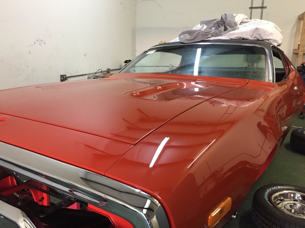

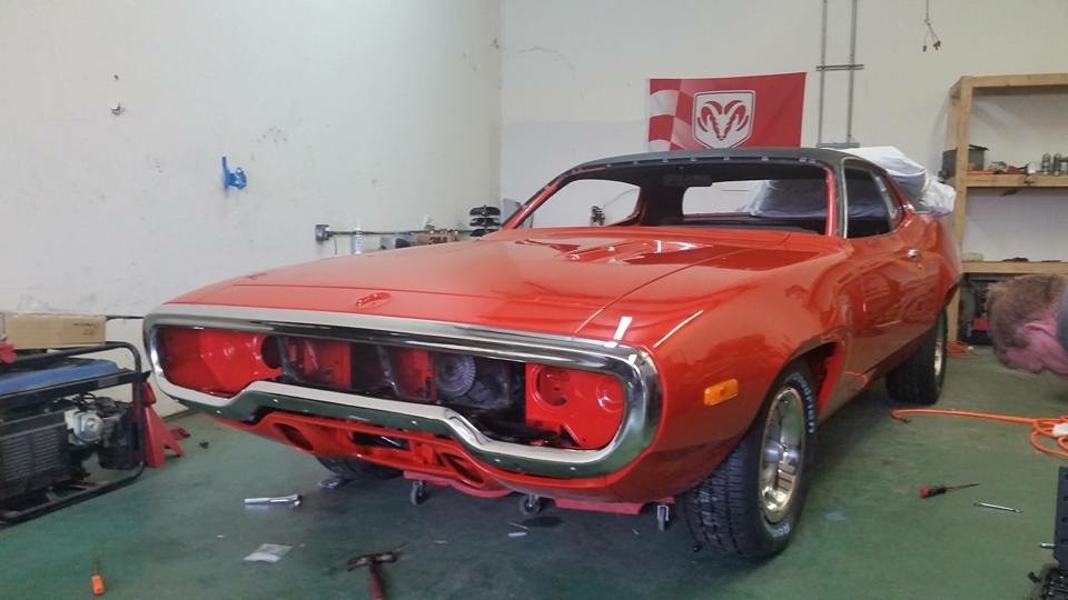

Almost ready to put the windshield and backlight in after painting the 72 SSP project car. What did the factory use to seal the glass? Do I use the same thing as the factory used back then, or just some kind of urethane sealant? Thank you.

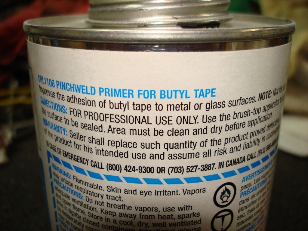

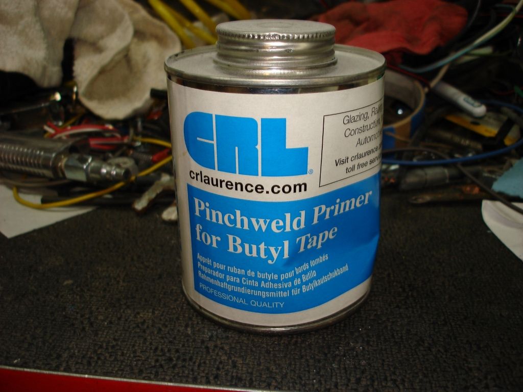

3/8" front. 5/16" rear, with pinchweld primmer specific to butyl. I back fill with 60 minute cure urethane sealer.

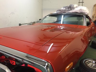

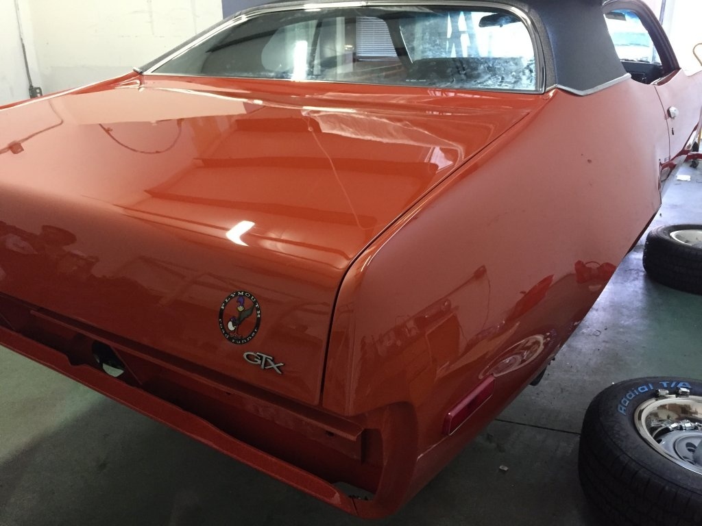

All glass has been installed, I can park it outside under the tree now.
