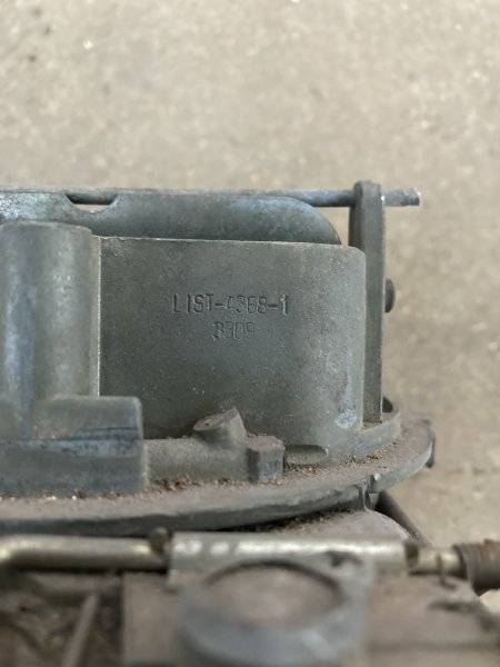

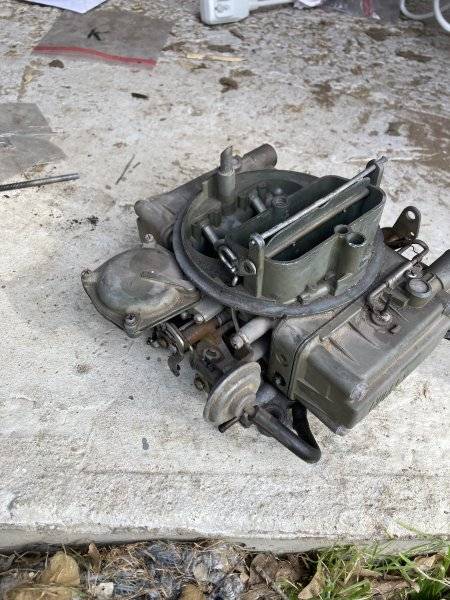

Further garage cleaning has unearthed everyone’s most peoples favorite carb, the Holley. Being a Carter/Edelbrock guy, this car has no use to me and I’ll be putting it up for sale. But I want to ask the wizards to make sure I have what I think I have.
According to what I’ve find, this is a 68-70 383 carb. Is my googling correct?
My info says R4440 for a 69 383 w/727,a/c. All other 69 rr combo's were Afb.
Looks like yours might be 70 only. It has a very late November '69 build date.
