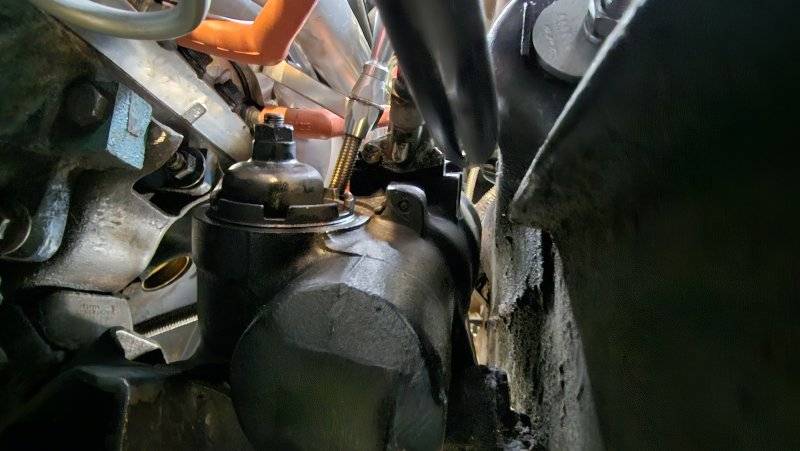

Ok... seems I jumped the gun a bit on this one. I had to let the headers cool down, and I took another look. Check the rubber hoses and they are good, however the metal line that goes into the power steering pump seems to be leaking... tightened it and still leaks, took it apart and no o-ring. I assume there should be a o-ring that goes in there?
Saginaw pump? Federal Pump? Both should have an inverted flare which doesn't need an O ring... Up to around 72 the steering box also uses inverted flare but starting around 73 they started using a SAE O ring style fitting...

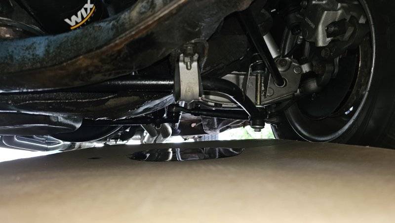

I seem to be chasing a string of leaks.

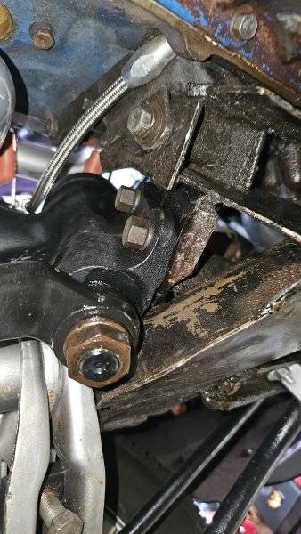

Fixes the line but does seem to be leaking from the box too. Is it possible to leak right where it attaches to the pitman arm ( I think it's called?)
The gear box itself seems dry, the rest of the car is wet though.
Pitman shaft seal... Is the steering box a 72 & earlier? Or has it been swapped for a 73 & later? The pitman shaft diameter increased in 73.. So the part changed... But replacement is the same either way... Pull the Pitman arm off... Remove the snap ring... Put a large drain pan under the steering box... Start the engine & turn the steering to full lock... Both seals & the washer will usually pop right out... Find a suitable sized socket/piece of pipe the drive the new seals in... Install snap ring, Pitman arm, washer & nut...Fill with fluid.... Crack a beer..
