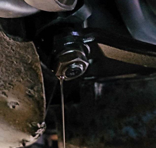

Yea... I took a picture with the car running. Not good. It just pours out! It's just irritating it's only a year old and the seals are shot.

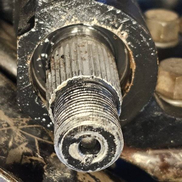

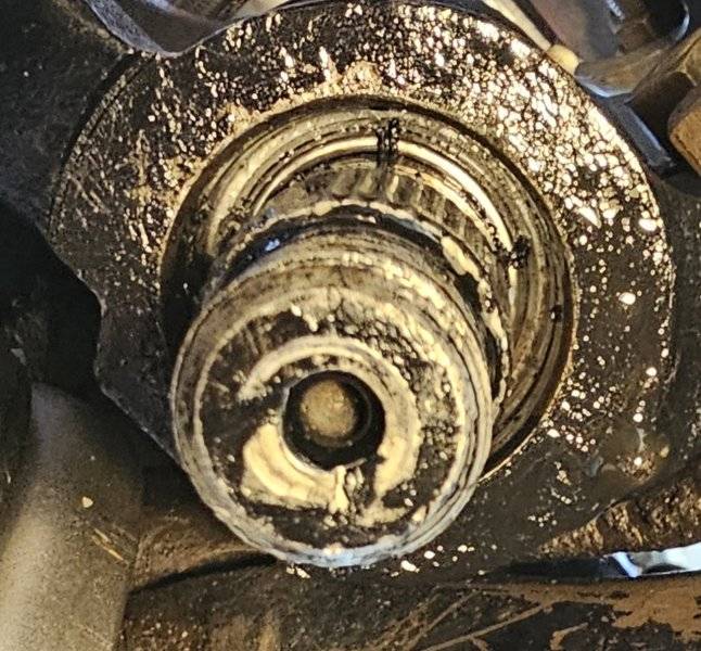

Well I just had a chance to look at this and I don't even see a snap ring in place! Nor do I feel a groove of any sort that it would fit into. Seal seems to be about 1/4' in.. Should I try to push it in a little further.
It doesn't seem to want to pop out either.

I wonder if Firm Feel used a seal like Ford use to have... Ford put an outer dust seal in after the snap ring... So you won't see a snap ring, just a metal & rubber seal... If that's the case, use a pick between the shaft & the metal portion of the seal to hook the seal & pop it out.. Then you should see a snap ring & the previously posted method works....

Well... I'm back. I did get the dust cover off, and the clip, and the washer behind that. However the seal didn't blow out. Why would it?
So tomorrow I'm going to try the drill and screw trick and try to pull it out.
Thing is... the old seal appears to have a metal ring around the rubber, so it's in there metal on metal. The new seal is just rubber.
It also appears the gear on the staft is larger the the shaft itself. The new rubber seal just slides over the gear onto the shaft and it retains it's shape?
Of course it seems I have some odd duck gear box, or maybe it's me, idk?

Some of the manufacturers use a metal cased seal... The point where the seal contacts the shaft will be rubber... The screw method should work... The start it up and full lock method uses hydraulic pressure to pop the seal... You've probably almost run out of fluid....

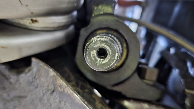

How far is it safe to drill? 1/4" or just kind of a feel thing?

Both of those apply.. What you don't want to feel is crunchy... The seal is 5/16 so 1/4 is safe.. Basically by the time your 1/8" in you'll be through the seal & into the open space... Stop before the next contact... There may be a second washer & there will be a second seal... Repeat as needed..
Ok after much fighting I got it out ! Looks like another dust cover though! I'll assume that stays there??
Seals out,, I'm happy!

Did you read the bold text? You want to see the lower bearing....
Yes I did. But the kit I purchased only gave me 1 seal, 1 dust cap, and 1 C-clip.
If I went any farther I would not have had parts to replace them with, so I went with what I had.
That C- clip can sure be a pain.
Anyway, I did get it done, and so far so good. At least if it leaks agian I know what I'm getting into.... and probably why.
