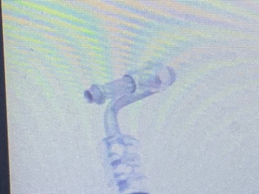

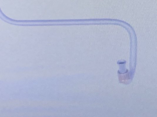

Ok... seems I jumped the gun a bit on this one. I had to let the headers cool down, and I took another look. Check the rubber hoses and they are good, however the metal line that goes into the power steering pump seems to be leaking... tightened it and still leaks, took it apart and no o-ring. I assume there should be a o-ring that goes in there?
Saginaw pump? Federal Pump? Both should have an inverted flare which doesn't need an O ring... Up to around 72 the steering box also uses inverted flare but starting around 73 they started using a SAE O ring style fitting...

73 pump & gear both use O ring fittings
72 is Inverted flare at both ends..
So... If someone put a 73 Saginaw pump/discharge fitting on your car & you have a 72 hose.... It could potentially seal but suddenly start leaking...
Best option, take the hose out & look at the fitting on the pump to see if it looks like the inverted flare in the picture...
I've searched but couldn't find a decent shot of the O ring port fitting..
