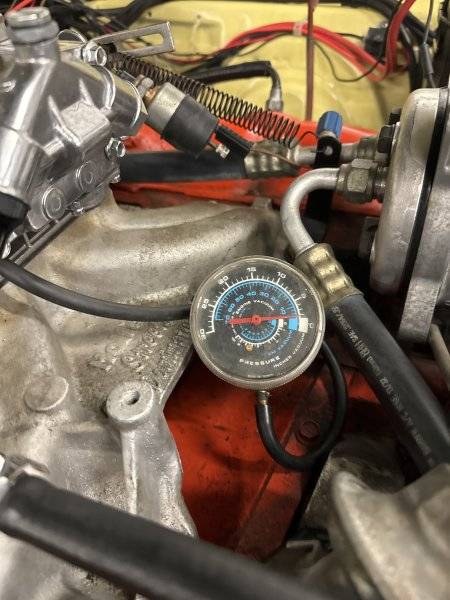

Next up, let's try the vacuum gage.
LOL
Apparently, the PO decided to plug this line. Hard to see in the picture, but there's a piece of plastic in there.
Now that's fixed. This car will have vacuum advance like the good Lord intended. Vacuum is now right around 14HG.
Yes, I am running manifold vacuum vs. ported. Both idle and vacuum are not terribly steady, and we're still after-firing.

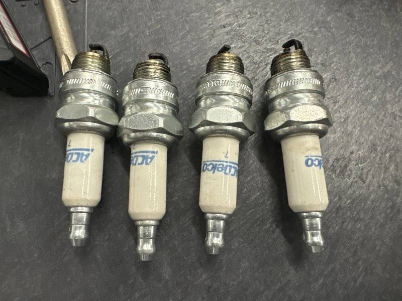

Just at a glance, the distributor looks incredibly advanced, but I'm not there yet. Let's pull some plugs first.
These are AC-Delco Platinum 7 plugs. Fancy! Somebody was a big spender.
They actually don't seem to have spent much time in service...

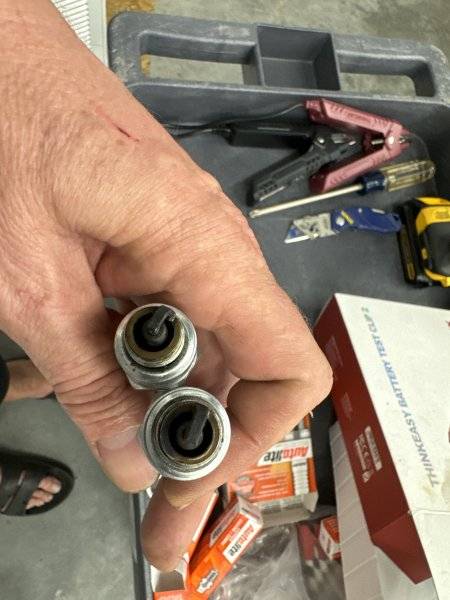

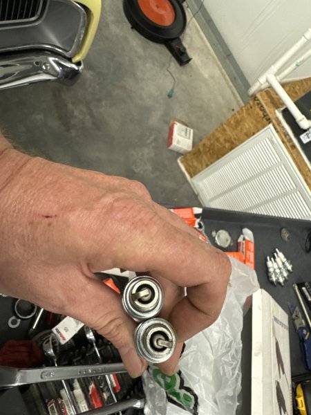

Did I mention these old plugs couldn't have seen much use?
Look closely...
DAMN. I think I just found my problem. Cylinders #2 & #4 aren't firing.

I need to figure out what would cause two adjacent cylinders not to fire.
A carb problem wouldn't cause this.
A coil problem wouldn't cause this.
Bad timing wouldn't cause this.
Odds are against two Mfg. defective plugs installed side-by-side.
I'm not going to worry about valvetrain issues until I run out of other ideas.

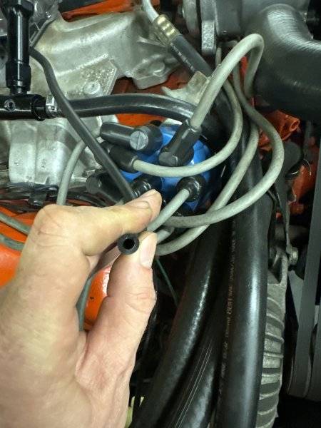

Maybe switched plug wires or a vacuum leak? Let me check and I'll report next post.
If that intake is an open plenum and for sure 2 and 4 are not firing I would suspect a vacuum leak. Either at the intake to head area or possibly a gasket on that carb. spacer.
Somewhere a village has lost their idiot.
Plug wires #2 & #4 were switched.
Running much better, however that's not saying much. At least the backfire (afterfire) issue is resolved.

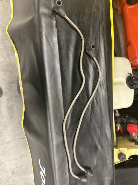

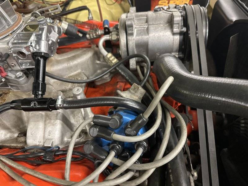

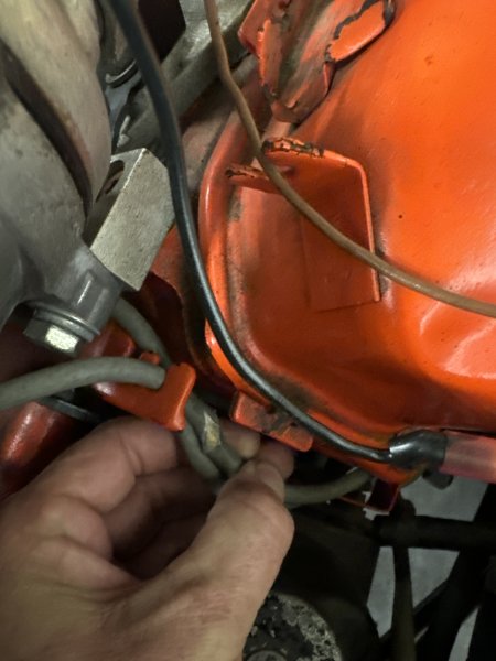

Anybody notice anything here?
Look closely...
For some reason, there's two different sets of wires here.
Everything needs to hit the trash.

I noticed the fuel line going over top the distributor and advance unit. Not ideal
