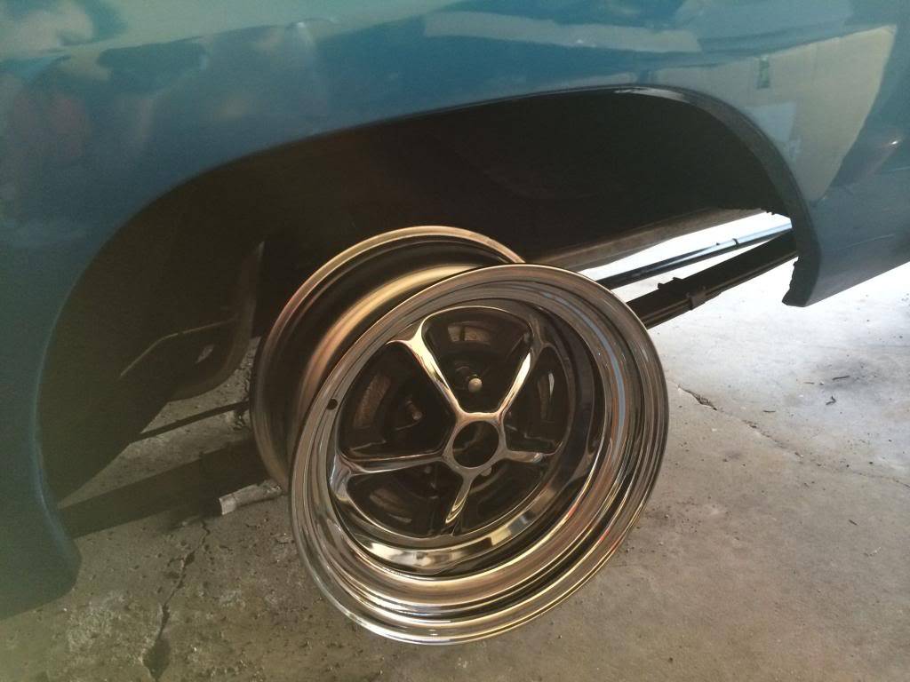

The charger needs a brake upgrade, manual drums on all 4 corners is just not something I am comfortable with. Looking at the offerings on the internet, it seems like most kits need at least 15" wheels. So I pulled a 14" wheel off the back of my charger (225 70R14):

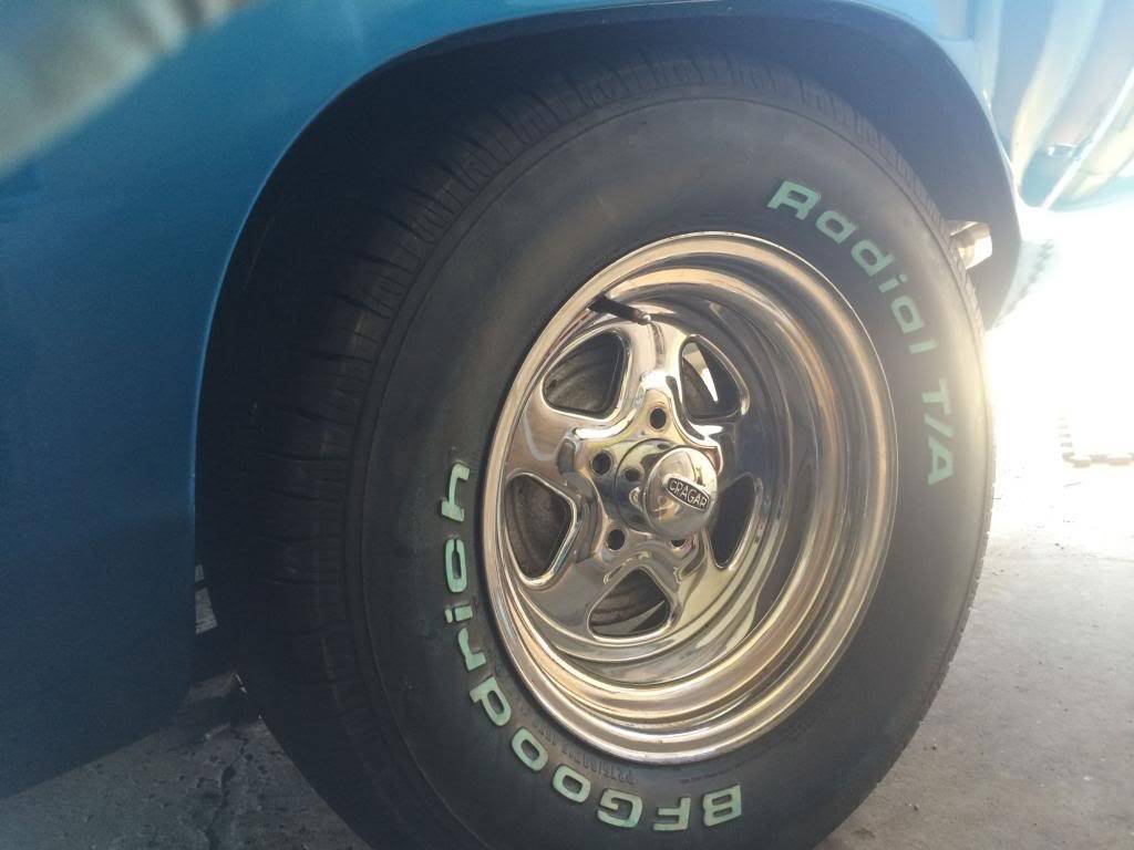

Then I swapped on one of the rears off my challenger (275 60R15)
So the 15" x 8" with 4.5" backspacing fit with tons of clearance. So now I can order wheels. When it comes to tires I'm not sure what I'll go with...probably Cooper Cobras for that RWL look.
