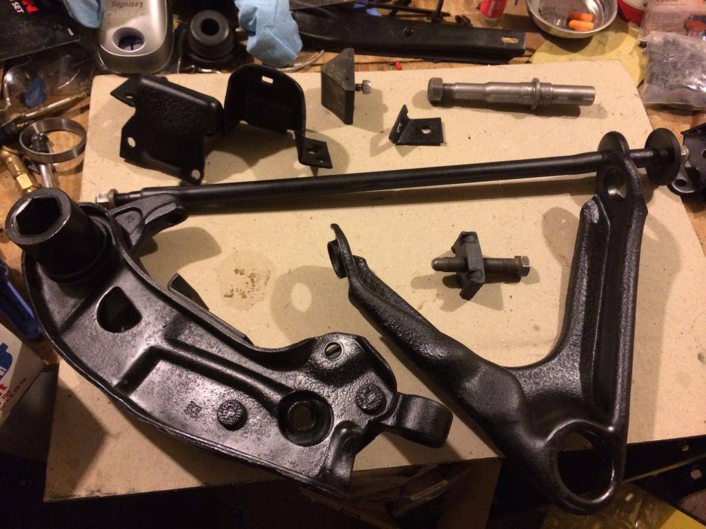

The UCA, LCA, and Strut don't fit completely in the bucket I was using so I did steps 1-3, then rotated the part and did steps 1-3 again. In the end they took about a week.
Scrubbing them with the brush took less than an hour most nights. It's just to break off some of the loose crud and help the evaporust work it's way in.
A stronger mix of evaporust might work quicker, but I just used the stuff I had on hand and the rest of the mix was water...probably about 75% water by volume. If I was going to do a lot of parts, I'd probably have gone 50%+
Hit the suspension pieces with some chassis black.

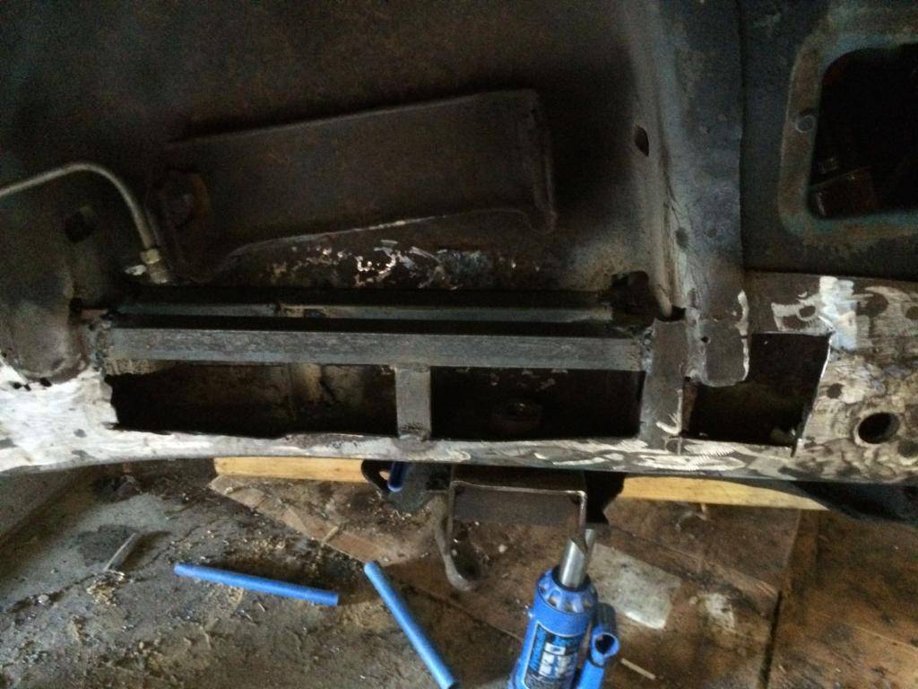

Added some metal back into the frame rail, I'll be putting a safe-t-cap piece over it once I get it fitted.
I had to pull the K frame bolt out, as the cap fits around it. You can see how much of the bolt was eaten by the metal worm:

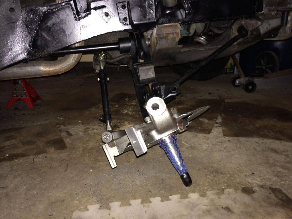

Lots of work repairing the frame rail over the last few weeks. I fitted the Safe-t-cap piece, got everything welded back together. Fabricated a top piece to cover the section under the UCA bracket, welded that in, then painted every thing. Once that was done I started bolting pieces back onto the car. This is where I ended up:
Unfortunately I had an issue with one of the UAC bushings and will have to order a new one (my fault). I still need to torque, grease and pin everything, but it went back together a lot easier than it came apart....well except for that stupid lower ball joint dust boot.
Nice work, looks like you had your work cut out for you.
That must have been some tedious work there, and it looks real good! Thats tuff having to do this kind of repairs, looks real good!!!
I'm a newbie welder at best, and welding the underside just plain sucked. If I had more time and material, it would have been great to do a few practice runs. A lift to get the car higher off the ground would have been great too. The engine bay welds were not fun either as access was equally limited and had to be done from the floor. At least for those the weld was horizontal.
Still it's solid and with some black paint on it buried in the wheel well/engine bay it's not too bad. But I won't be welding any finished sheet metal any time soon :)

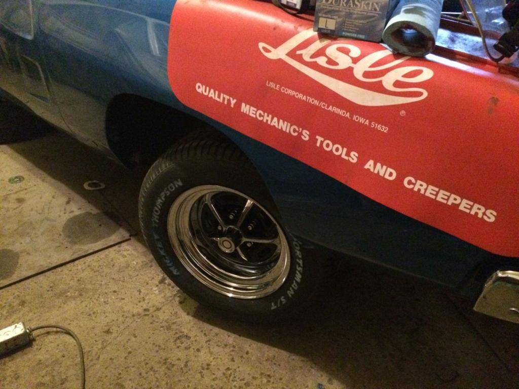

Removed the damaged UCA bushing and pressed a new one in. Then after a lot of persuading with the rubber mallet I reinstalled the UCA. I then tightened, pinned, and lubed everything.
After that it was time to slap on a wheel....and now it looks like a real car once again:
Now all I have to do is remove the old master, install the new booster / master. Bleed everything. Balance the wheels, do an alignment, etc
thumbsup.gif Love to see the whole car as nice as that P-side front looks! Thats great work to get it right and those wheels really look good on it!

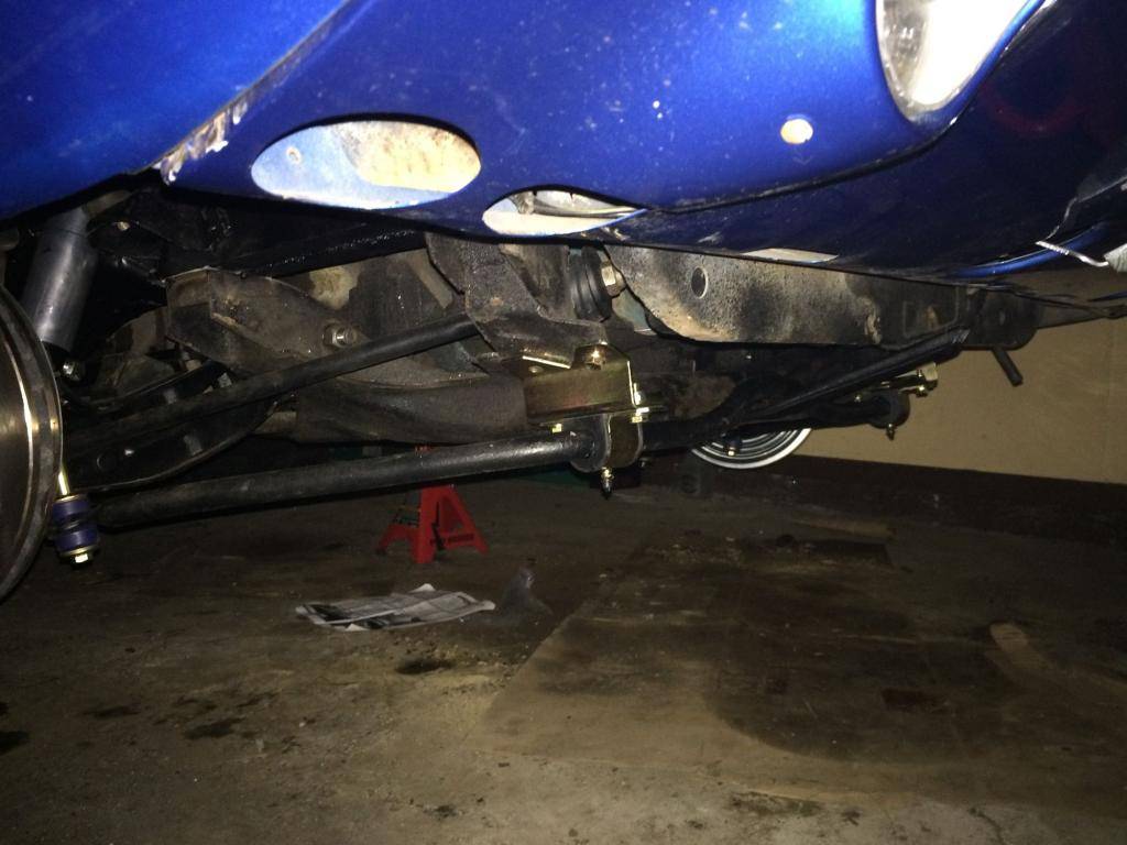

I bolted up the sway bar, that was the last piece of suspension that needed to be attached. I tried the stock brackets, but getting the bushings in was just going to be too much of a headache so I picked up a pair of Energy Suspension ones that are greasable:

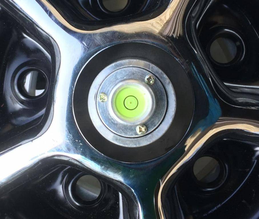

I also balanced the wheels using the bubble balancer:

Ive never seen one of those "bubble balancer" that's pretty cool, i guess i need to get out more!!! Real nice and thanks!
Bubble balancing is old school. It only statically balances the tire. Dynamic balancing performed by modern wheel balancers at a tire shop is actually better, but I don't have a lot of luck with tire shops and prefer to do the work myself. Plus bubble balancing was used for ages so it should be good enough for my street car
I agree, I cant see why it would cause a problem, i only used the shop who put the tires on, but this is a tool i wouldn't mind having here!!

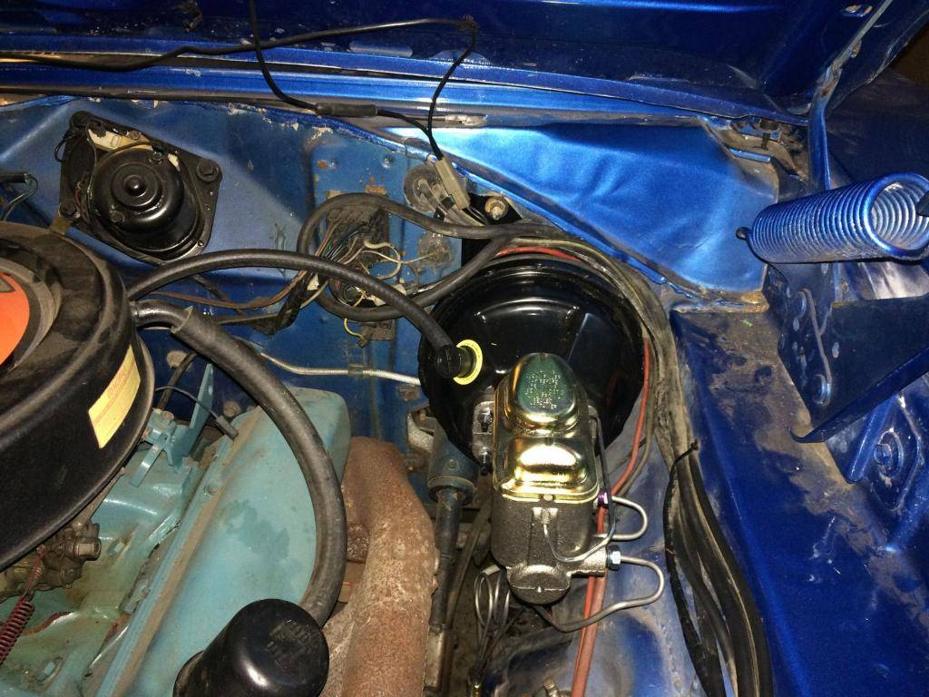

I got the booster on...and was happy....for about 2 hours and then I figured out how the pedal linkage was designed to install. Next day I tried a few things to get it installed, but no luck the booster had to come back out so I could install the pedal linkage. I managed to get it installed, bleed the master, and get that installed as well:
Everything will look much better once I have a chance to get the car out of the garage and clean it.

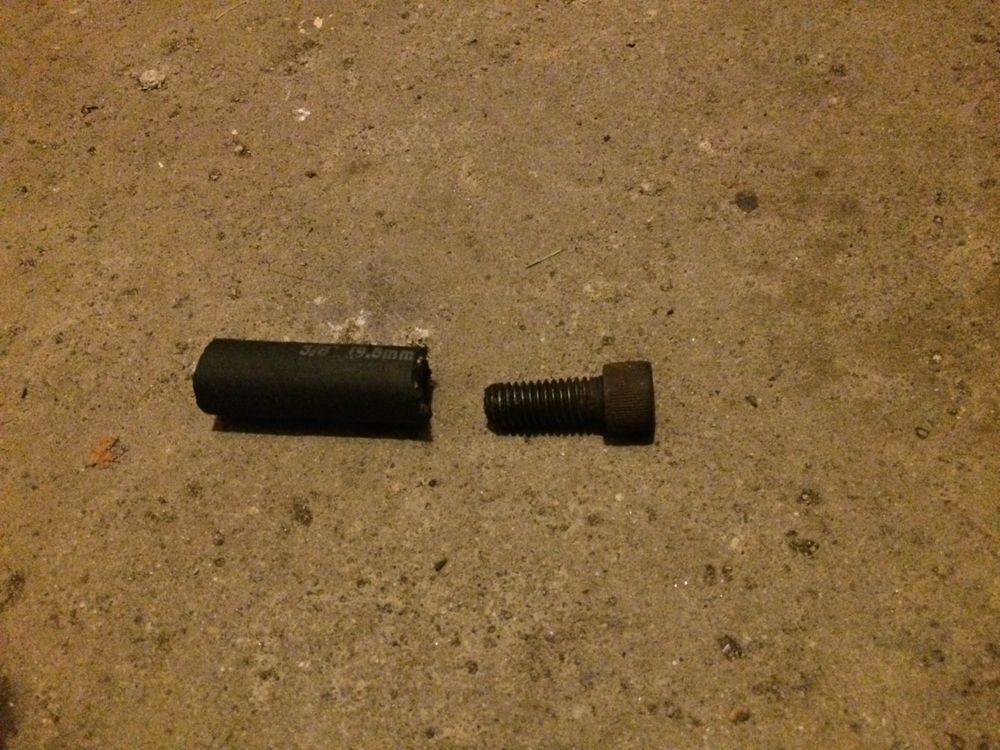

Hooking up the vacuum hose of the booster, I found what I thought was a cap on the vacuum tree was actually just a piece of hose with a bolt shoved into it....not even any sealant.
Sigh

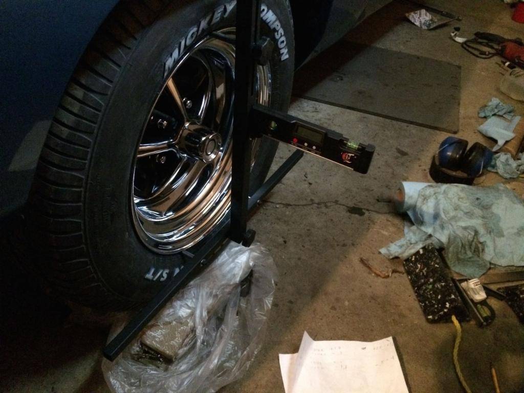

Started on the alignment, but after a few minutes it became clear I had no idea what I was doing.
I've been doing some reading and think I have a better idea of which way to turn what bolt.
