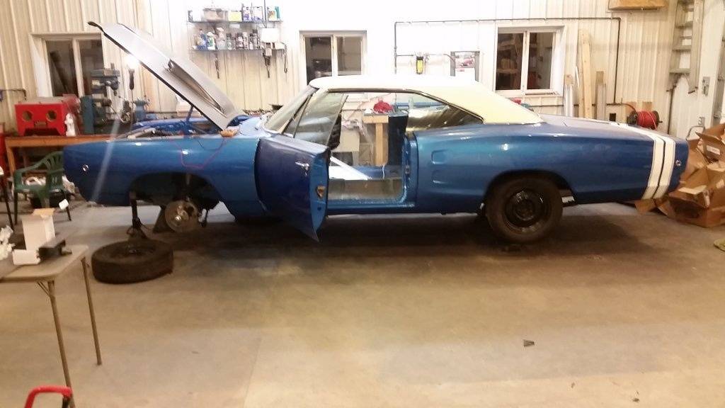

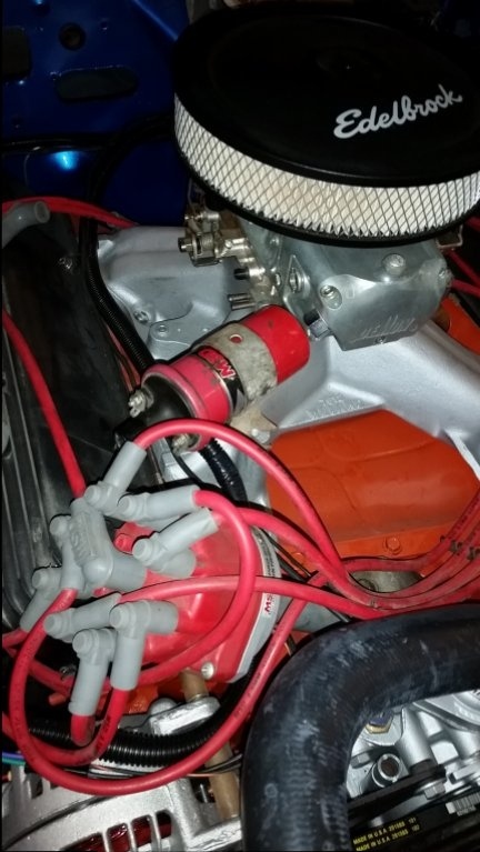

Here's where we are at. Winter has been Crazy busy at work! We are just finishing up a new house, have 2 other remodels going on, and are starting to dig for the next new house this coming week. I need some more guys. Been looking, but it is hard around here to find someone who wants to work, and doesn't already have a job. If the are looking, they have a criminal record as long as my arm or are just lazy asses. Anyways back to the car. Brakes are done! We have all stop and no go. Engine compartment wiring is 95%, front wiring done except turn signals. Need to finish rear wiring. I gave to move my coil to the inner fender because of a slight interference issue.View attachment 409467I guess it's not that bad unless I want a fuel line, haha.

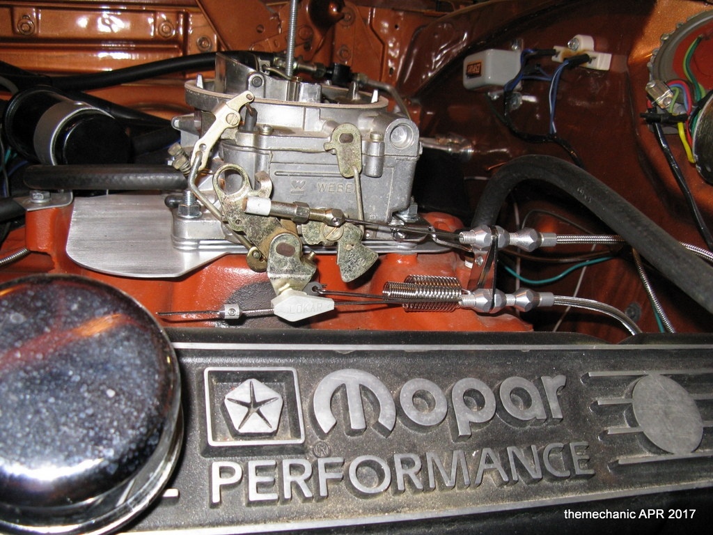

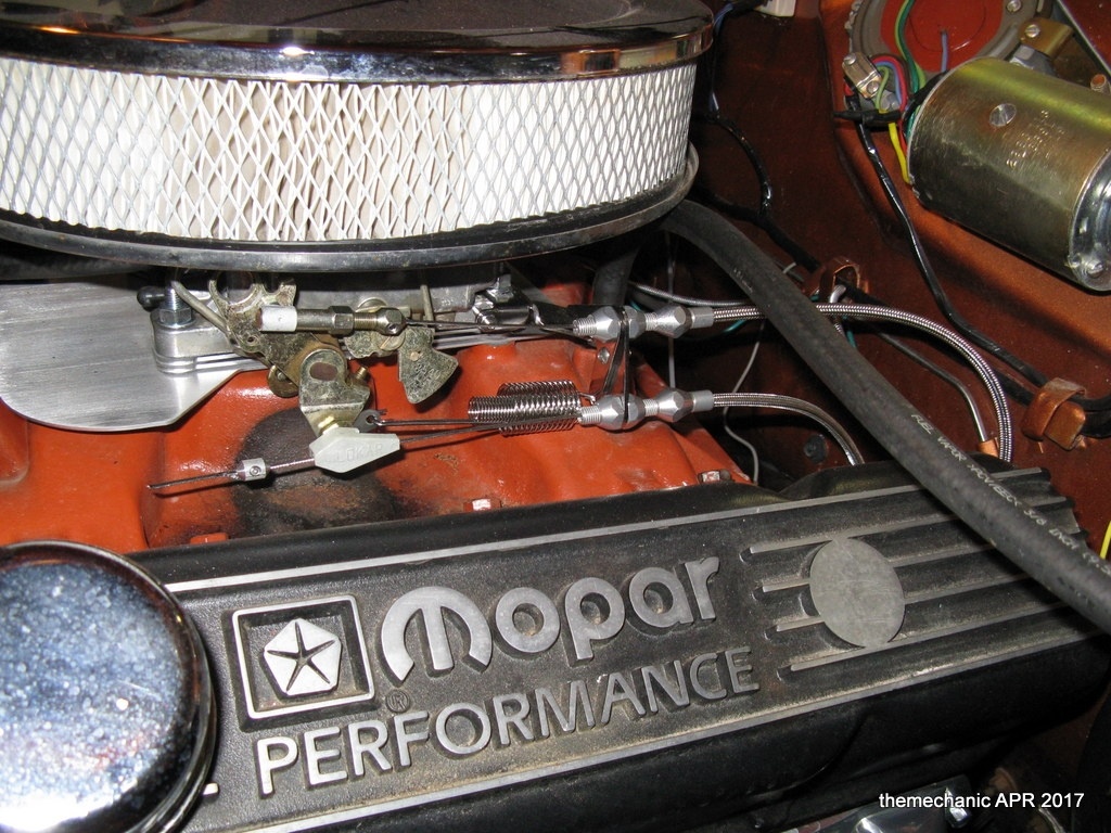

What is everyone running for throttle brackets, throttle cable, and kick down cable? Must fit a demon carb.
I have the Lokar throttle and kickdown cables. They look great and work well and were easy to install and adjust. Some prefer the Bouchillon cables, though. There was a recent post about this question.
Here they are before I changed intakes and carb.

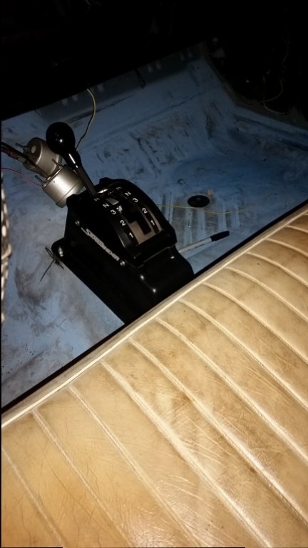

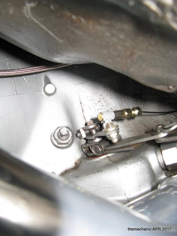

Making some progress. Got my shifter installed. Just have to route the cable and hook up the linkage.

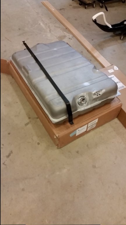

Got the gas tank, just waiting on the tank pad.

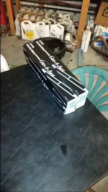

New shocks came in today. LOKAR throttle cable, kickdown cable, and the rest of the wiring will be here next week.

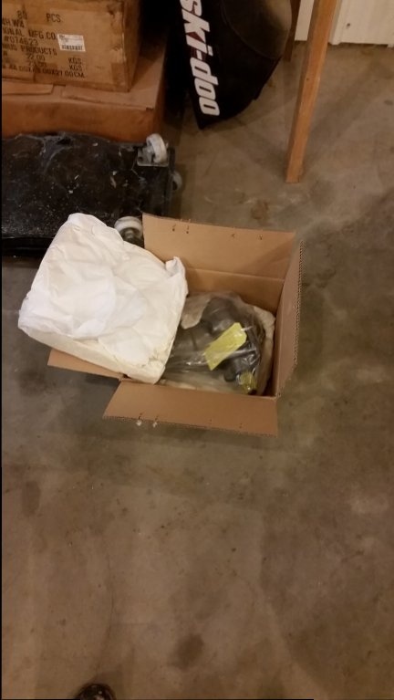

New steer gearbox came today.

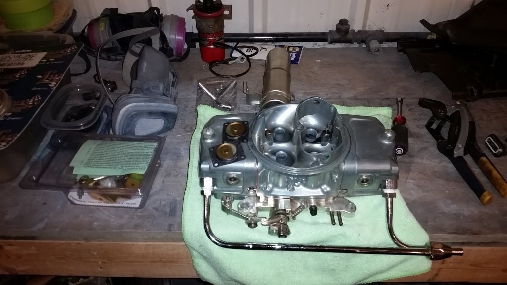

Gotta throw a rebuild kit in the demon, the accelerator pumps were rock hard.

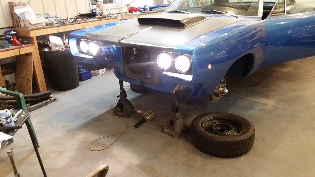

Monday I have to drop the drive shaft off to be shortened. I decided to black out the entire grill. She is gonna look mean.

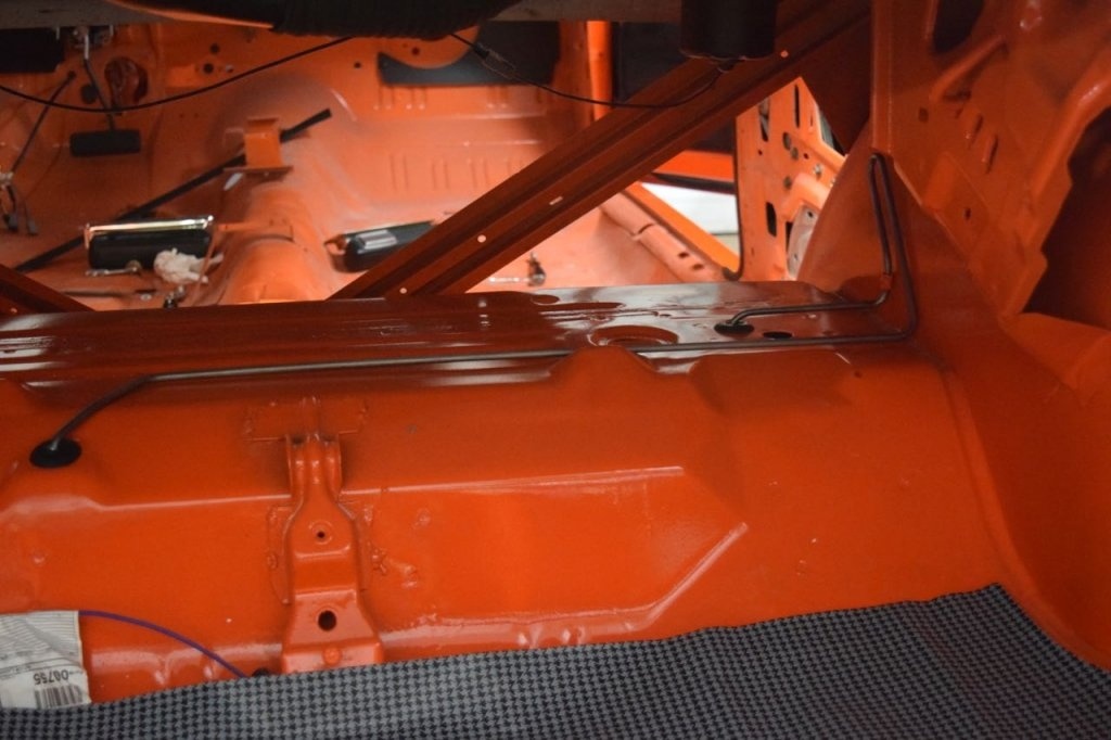

Underside. Sorry for the blurry photo, it is all I had. Also I have the FI tank so it is different. There are 2 vent nipples on the stock tank. See which one lines up with the hole in the shock brace, you can see the vertical vent pipe here connected to the special scissor clip that holds the line to the shock brace. Also the metal strap that makes the electrical ground for the sending unit jumps between the vent nipple and this short pipe under the car. I am amazed the sending units work as well as they do with such a really poor grounding system.
I wish I had known you were buying KYB shocks. I will be selling my practically brand new KYBs since I swapped them for Bilsteins.

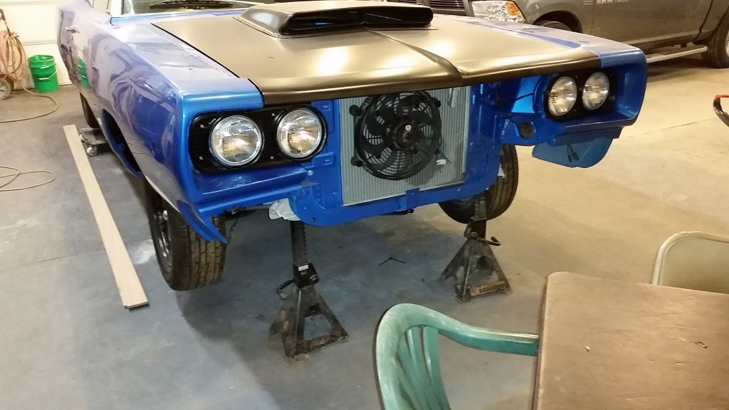

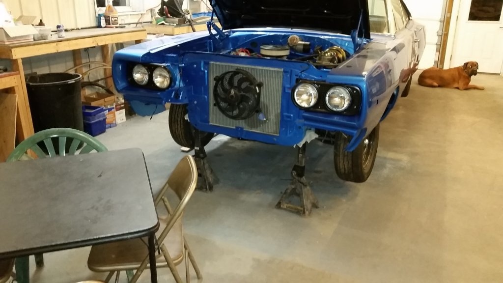

I noticed you have an electric radiator fan. I heard they draw a lot of amperage. Did you upgrade your your alternator?
