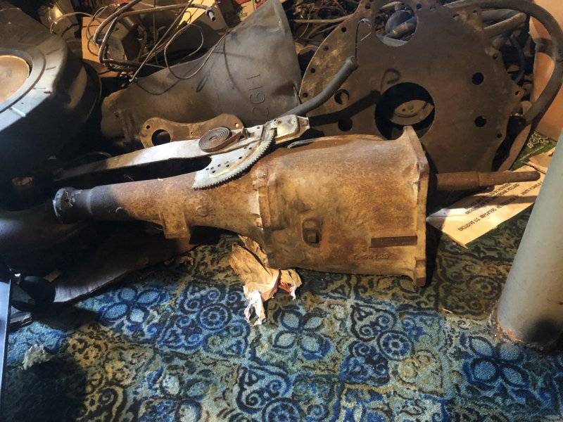

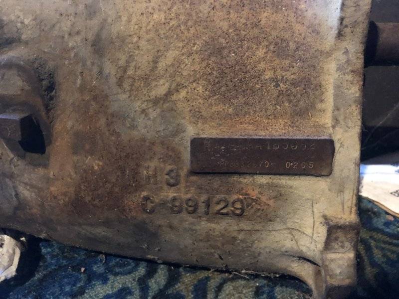

I agree. I was pointing out it would be easier and much cheaper to put a 383 back in it. I got this 23 spline 4 speed for $50 a couple years ago. 383 parts are much cheaper than 440 or Hemi parts. The VIN says it was out of a ‘69 RR.
I’m not sure why Mopar guys seem to always worry about worth.
I agree. I was pointing out it would be easier and much cheaper to put a 383 back in it. I got this 23 spline 4 speed for $50 a couple years ago. 383 parts are much cheaper than 440 or Hemi parts. The VIN says it was out of a ‘69 RR.View attachment 1322023View attachment 1322022I’m not sure why Mopar guys seem to always worry about worth.
Cheaper ? Oh, absolutely, not even close. I agree wholeheartedly. But, in the long run ( good Eagles song ), for pleasure drivability if keeping, or resale purposes, I'd do the resto-mod route. Funny, I'm far from a "resto-mod" guy ! But, if I got a shell of a plain 383, that's where i'd go. That's me. I did that to my 70 plain-jane 383 car, transformed it into a retro 70's 6-bbl car... like I had... in the 70's !! :)
