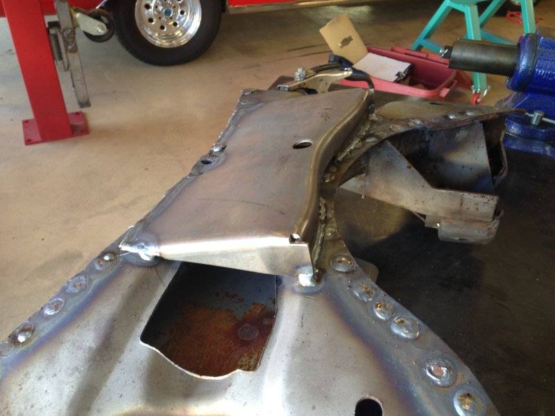

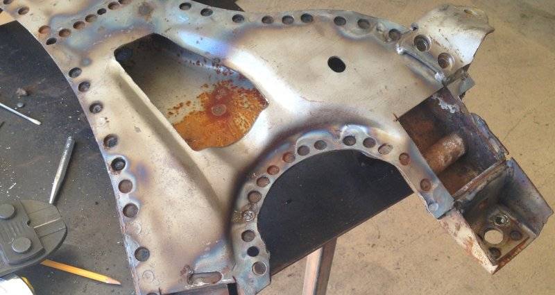

Later on here, I added in reinforcement pieces around the steering box mount. Also finally had the chance to trim off the excess material from the engine mount brackets. Partially just because and the other to gain more clearance for the oil line from the pump to the pan. Milodon external pickup road race pan. So, have your pick of ideas. There is plenty to do and is all up to you on how far you go, or how much time you spend.

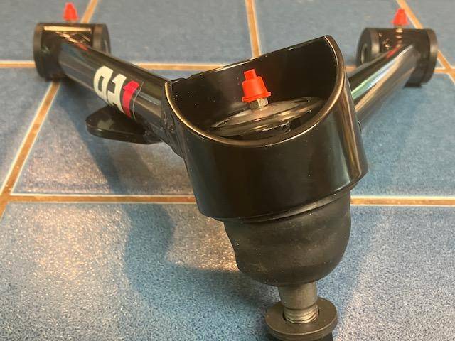

I have the QA 1 upper control arms and front sway bar. They seem like quality pieces.

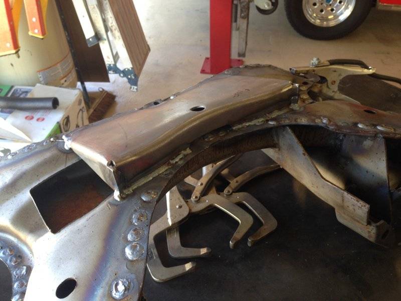

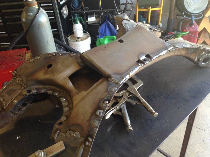

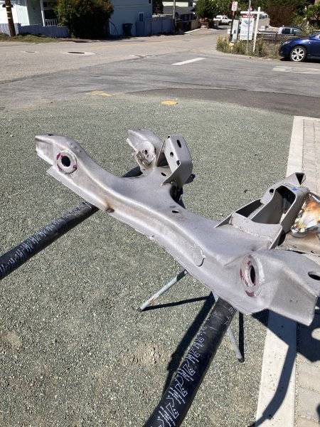

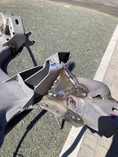

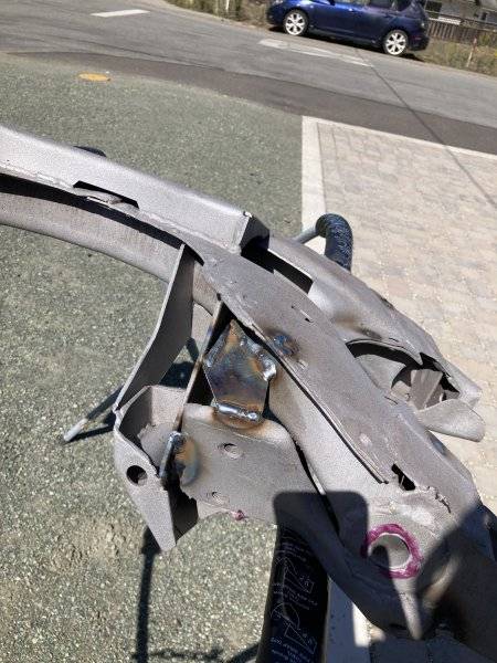

Plus a skid plate. From the factory, the K had around 40 or so plug welds. I added in over 120. Used a Blair Rotabroach[ hole cutter] set to cut through one layer with the exception of the Idler Arm mount. Two layers there with different sizes. Cut pockets below the lower control arm shaft sleeve so I could get both ends of it welded as much as possible. On the control arm side of the sleeve and the nut side, added structural steel washers to give more contact area and welded them all up. Where the strut rod goes, I boxed that in on the sides and top. Top you can see where I plug welded to the boxing pieces. Nut side you can see where I added plug welds to the oe reinforcement plate. At the ears where the K bolts to the front rails, punched holes there too to plug weld the two layers together. Skid plate is self explanatory. I had that K tanked twice and there was still grunge in the seams which would boil out when welding. Thats when I got the torch out. Burned the rest out so I could finish.

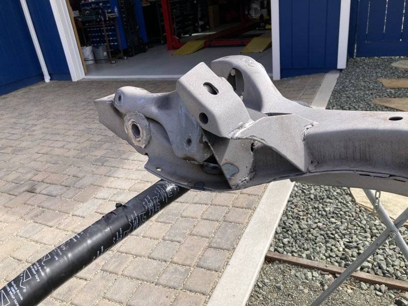

I also went through Firm Feel for the K member gusset kit, skid plate and LCA stiffening plates. The LCA's were worn and a little sloppy, but after cutting them loose and welding back together with the stiffening plates, much better. The K-member kit was a fun little puzzle with all the little pieces and support washers. I bead blasted the K-member and set up to start welding. I didn't rota-broach the edge, although that is a good idea, but I did stitch weld around the edges. Then I had the whole unit powder coated. I turned out alright. Now it sits in the car awaiting it's power plant.
