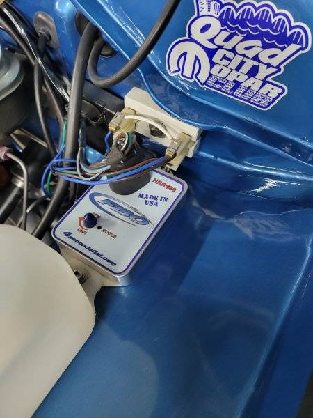

In stalling a Firecore dist and coil on my 66 (no orange box or ballast resistor) and the coil must have a constant 12v while running, what keyed source can I use to power it? Some have said go off the radio splice but would that be enough to power the coil or would it interfere with sound? The brown wire was used on the old GM module/blaster coil+ I switched from and only powers at start, any suggestions on a good keyed source? Also do I need a fuse on the new wire and if so what amp, thanks
The same keyed source that is already there, you just jump the existing ballast connections together, or better yet make a dummy ballast so it looks factory.
Like dadsbee said, just make a jumper wire for the ballast. Use piggybacks for the extra terminal.

That wire is the factory ignition circuit. And yes, it also feeds the VR.
