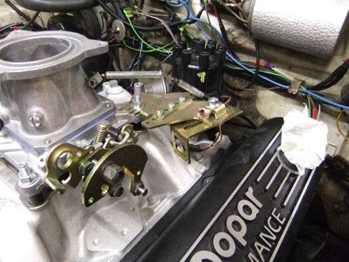

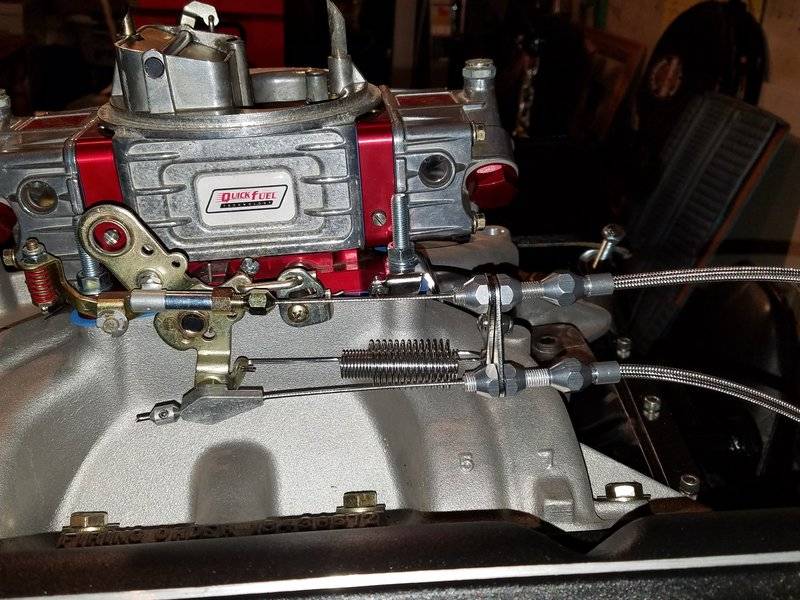

I prefer the Lokar for both when factory originality isn't a concern. To be fair here, I have used both the Bouchillion and the Lokar, and I've had equally good functionality with both. For me, it basically comes down to the lokar just looking a whole lot better and cleaner... I'm not a fan of the big gold metal pieces that you have to bolt on with the bouchillion. Just my opinion...
Lokar
Bouchillion

Bouchillion
Thanks. That is a cleaner look. And doesn't appear it would be in the way of the ramcharger base.

I don't have the exact part #s, but I do remember buying them from Jeg's (for some reason!) Kickdown cable assembly was 'Lokar TF-727', and for the throttle cable I bought the 'Duo-Pack' universal kit...it came with all the necessary bracket and springs for both cables. The throttle kit, if I remember, comes in a lot of various lengths so get one that offers you enough length to make yours work. Ran me just under $200 for the whole ball 'o wax....:eek:
No complaints once I had everything in and adjusted.
i got the lokar kit also works good, all on one bracket, clean.

Bouchillion
I'm running the Bouchillon setup and have never been happy with it. It's super sensitive to that slot adjustment and if I go too far towards the firewall my idle is too high, but not close enough to firewall and the kickdown barely works. I think my springs may be wrong also. For supposedly not working as well, the Lokar setup looks much cleaner.
