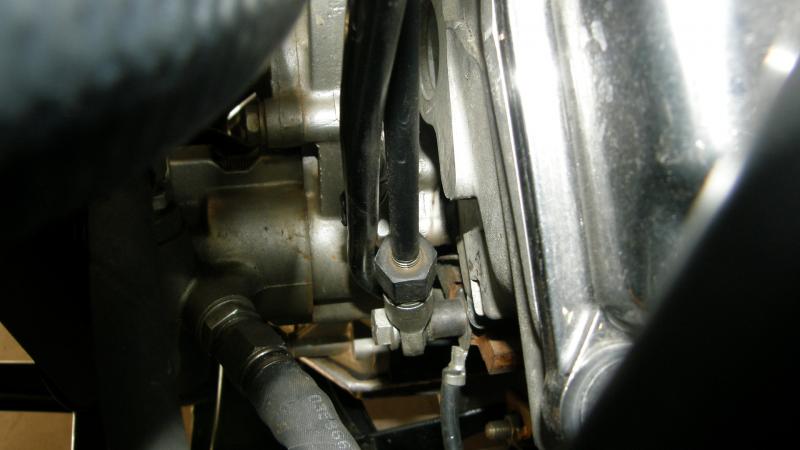

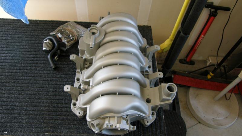

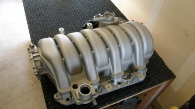

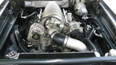

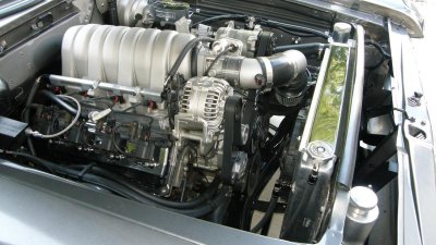

On a side note, I went back to the car intake manifold after shaving the tits and such off, painted it and now the under hood temps are better, still quite warm from the heat off the headers so I may, during the winter, put some header wrap on.
Here are some of the 6.1 on the car and the car 5.7 manifold all dolled up.

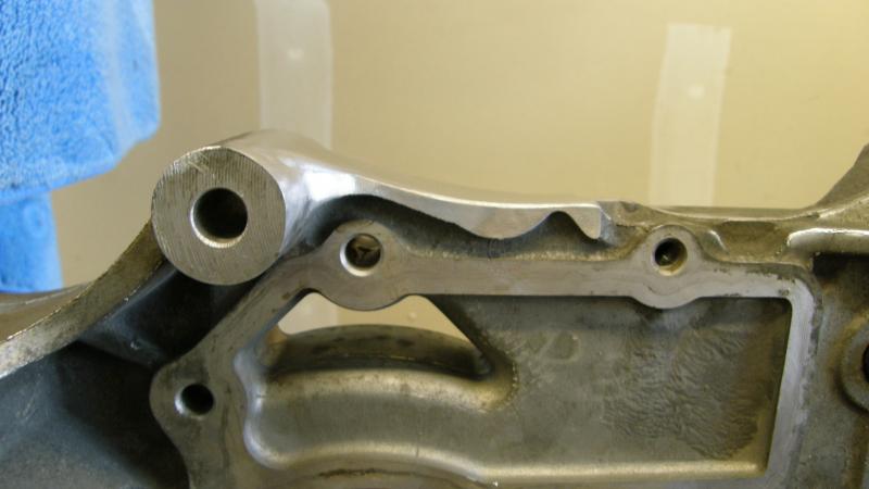

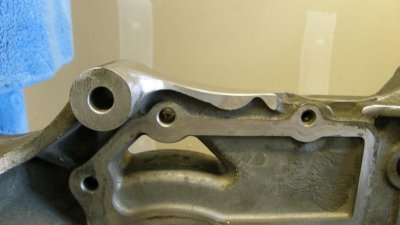

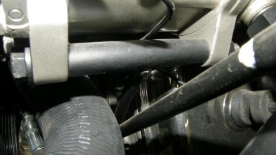

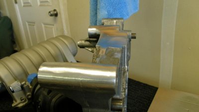

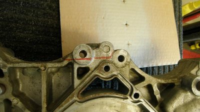

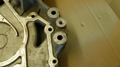

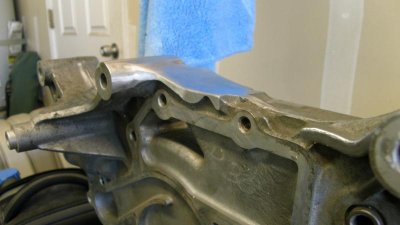

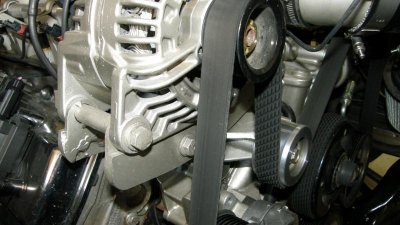

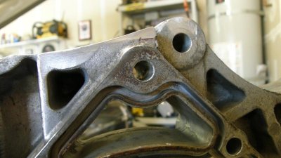

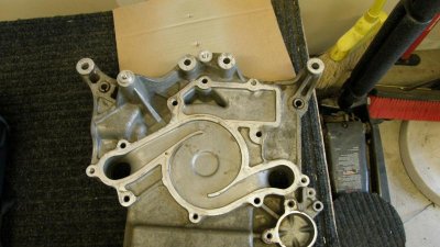

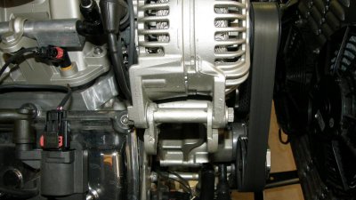

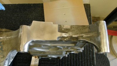

truck timing cover modified
I did this so anyone wanting to run the car or 6.1 manifold could do so and ditch the truck manifold. You will need to make brackets for the alt. and a/c, but if you put in a hemi, this should be easy. I can do this on an exchange basis and so pm me and I'll give details. I included a few pics to show what I have done, you may have a different alt. and a.c compressor so your brackets may be different than what I did.
