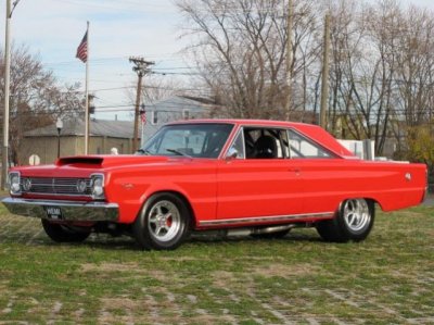

So I am finally back to working on my 66 Belvy. I have to make some decisions in regards to my rear suspension. The car is mini-tubbed, have relocated the leaf spring mounting areas inboard and the car retains the stock rear frame rails. My question is about leaf spring selection and ride height.
I wish to achieve the ride height (rim to wheel opening relationship in truth @ rear) of the Red 66 I have pic's of shown below... This car is a 4 link car (not mine) but has in my opinion the perfect stance, can anyone help me out with leaf spring selection that will give me this ride height? I want to order a set asap... The car will be a street cruiser with the odd trip down the 1/4 mile.

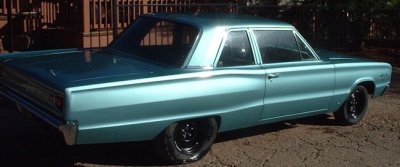

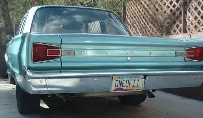

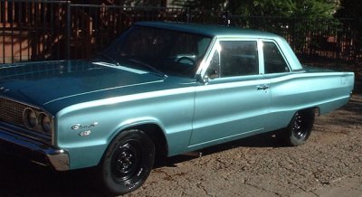

I like that too but would like my front end to up maybe another inch. It's kinda hard to order springs for exactly what you want. That car looks like it's at about stock ride height based on where the wheel is located. The large tires make it seem higher. Here's mine. The springs on it were old and flat so I threw on some air shockes (with a separate line kit) to raise it about 1" and clamped the front segment. If you get springs that are a bit too high, you can always install lowering blocks. I've made them from solid blocks of aluminum starting at 1/2" to 4". Don't pay attention to the dirt and dullness....it was a daily driver.
I thought of using lowering blocks if necessary, would that have an effect on spring wrap up? Your Belvedere looks pretty sound Cranky!

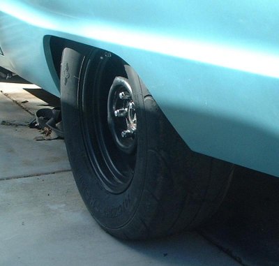

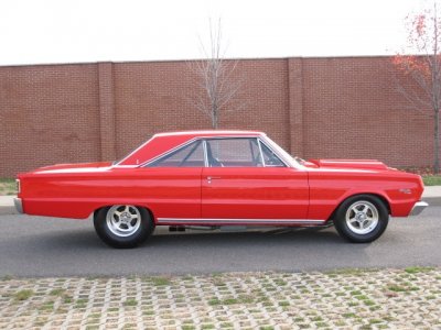

Here are some pictures of my 66 Hemi car. All is stock, no tubs or springs move. It has the factory Hemi rear springs, no lowering blocks, etc.
These are 255/60X15 drag radials on 7" wide rims.

Here are a couple of side shots.

Thanks 696pack, very nice car... that's the height/rim to 1/4 relationship I want, I just don't want to order the wrong springs. I will try and find a set. And that's the next gamble, finding a manufacturer...

I played with a 67 383 4 speed Coronet in the 70's using 4" blocks and it did fine. I expected wheel hop too but never experienced any with it. Man, I did all kinds of crazy stuff with that car lol. Wish I still had it but who knew! Yeah, the Belvedere is surprisingly solid. There's one small area behind the rear wheel. Hard to notice in the pic and there's some in the left rear seat foot well. Looks like someone turned a battery over because it's perforated in that area. The car has factory ac and came with rubber floor mats and those were usually bad news for ac cars and the floors are perfect everywhere except that one spot. Even the spare tire well was good.
