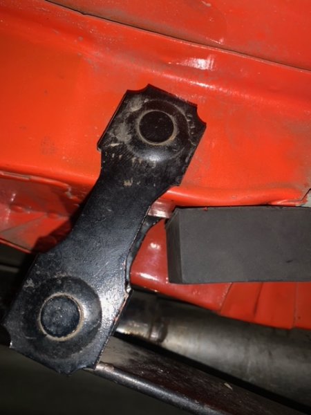

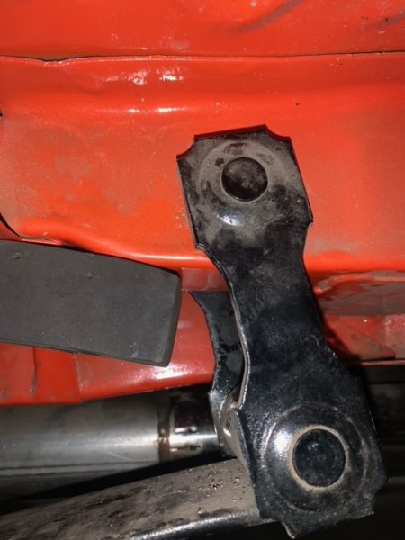

The first image is of my right shackle and the second my left. The right shackle The right shackle arrears to be leaning slightly more to the back of the car than the left.rsto beWrong Springs or incorrect hanger?
Shackle should lean backwards if spring
length and front hanger length is correct!

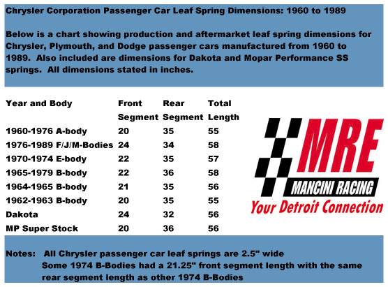

So the correct length of a Super Stock leaf spring for a 1969 Super Bee should be 58 inches?
Using the chart, a stock spring for the Bee is 58 inches. A SS spring is 56”.So the correct length of a Super Stock leaf spring for a 1969 Super Bee should be 58 inches?
That would do it.Using the chart, a stock spring for the Bee is 58 inches. A SS spring is 56”.

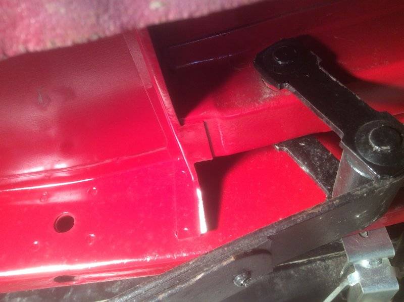

My 65 Dodge driver's side shackle with SS prings and 2" extra front hangers. Both drivers side.The first image is of my right shackle and the second my left. The right shackle The right shackle arrears to be leaning slightly more to the back of the car than the left.rsto be View attachment 1556032
With the measurements my Cousin gave me my leaf springs are in between the length of a stock spring and a super stock spring. Besides the length of the spring are there any numbers or other identifiers that will tell you if your leaf springs are stock or super stock?Using the chart, a stock spring for the Bee is 58 inches. A SS spring is 56”.

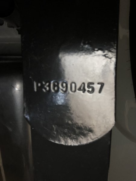

Per Google search my 440/6 Super Bee curb weight is 3845 pounds so don't know how exact you have to be when ordering springs (example 3800 or 3900 pounds). From your picture example the part number is stamped into the shortest bottom leaf. Do only Super Stock leaf spring part numbers start with a P in front of them?There is a part number stamped on the spring. Google the number to determine the spring.
For example, P3690457 is the left side spring for a 3400# car. The right side spring is P3690456.
P meaning Super Stock?Part number is stamped on the bottom leaf just behind the diff.
Use a 3800# spring; there is no 3900# spring.
P indicates a Mopar Performance part.
Check the part numbers on your springs to determine what springs you have.
O.K. I will assume a Mopar Performance part would indicate the spring is a super stock rather than a stock spring if the part number starts with a P.P indicates a Mopar Performance part.
