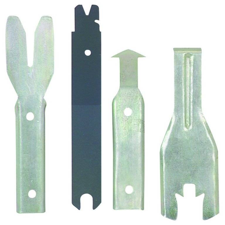

So my question is how do I fix this once and for all. It is new glass with a new gasket. I even had him use liquid butyl rubber under the gasket and I filled the glass groove as well. Is there a better gasket? Also what's the trick to carefully removing the trim?
Maybe it's not the windsheld. Could be coming in through the cowl or maybe the seals around the windsheld wiper things. If these seals were never changed, they will dry out and leak. Just some thoughts. My Roadrunner still has a leak some where that I'm trying to find. As for removing the trim, there is a special tool just for that job. It slides between the windsheld and the trim and releases the clips. Good luck
Can someone point me to the correct tool?
As for the wipers and cowl, I know the cowl has no leaks because I had to replace the top and was able to inspect it... excellent condition and yes the wiper shaft seals were replaced. Also I have been able to replicate the leak using pressurized water and it is getting past the glass, just don't know whether it's around the glass or the body?
The tool is like the pointed one second from the right below.
They sell this kit at Harbor Freight.
https://www.harborfreight.com/4-piece-windshield-door-trim-tool-set-38386.html
Thanks, I'll get one coming.

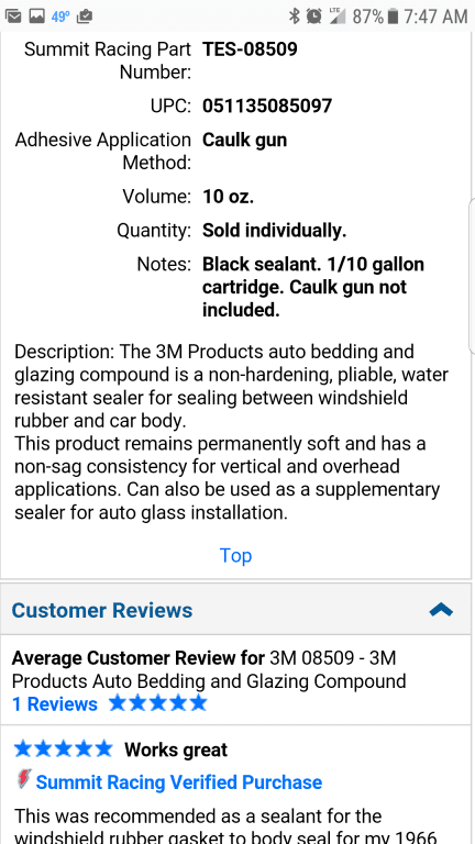

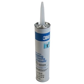

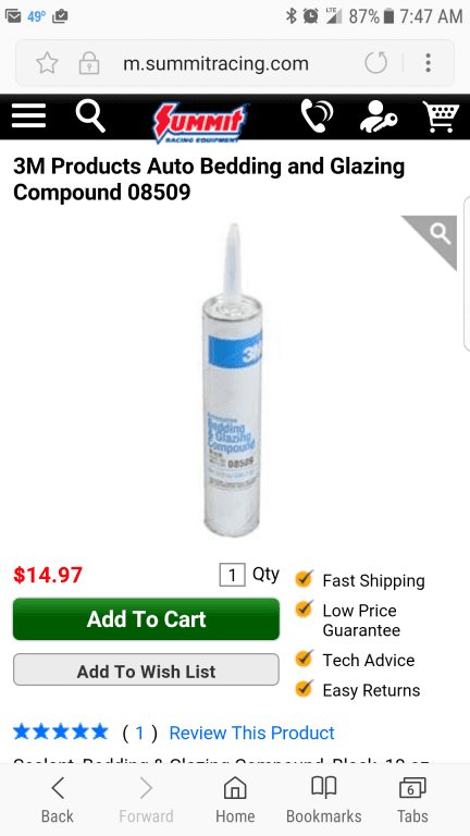

Bedding compound for the seal to body.
Liquid butyl for the glass to seal.
I'll look that up, so no butyl between paint and gasket. Thanks
After looking it up I'll chalk up the leaky windshield to both myself and the glass installer not having a clue!!!! Thanks missle, looks like I'm just not old enough to know better lol.
You can use gobs and gobs of something like this that will never set up. It can be easily removed with mineral spirits.
