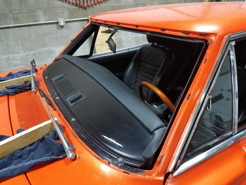

Pulling the trim and glass was a breeze thanks to you guys pointing me to the right tool, cleaning the left over butyl not so fun but everything looked really good once done. I would have taken more pics but once I had the caulking tube malfunction I was covered in the crap the rest of the night..... looked like a 2 year old installed it! I'm pretty confident it CAN'T leak anymore but will let you guys know.:thumbsup:
All in all..... I don't ever want to do that again, what a mess! Hours of cleaning both me and the car.... got it on my shirt which started tracking it on the car then no shirt:BangHead:.
After reading the label on the new gasket I saw 66-72 B body, sumbitch.... the car I bought my daughter will require the same thing!!!!:BangHead: Think I'll buy the sealants and advise a pro on how to do it instead.

I don't think it was the windshield, he filled the windshield groove in the gasket with butyl the last time and the way the seal locks it should allow for slight thickness differences. I'm almost positive it's the piss poor design on the cowl, there's no lip or anything just a valley that the gasket basically lays in with 3 tabs that hold the gasket. I'm pretty sure the bedding compound that Missle recommended is the trick, it's about like soft roofing tar in texture and flows really good when you lay the gasket in. Pretty sure it will seal it. If it's your glass all you have to do is pull the trim, unlock the gasket and apply butyl in the slot and lock the gasket back in.. messy!

I was worried about this very issue when I went to remove my non leaking original tinted windshield. What I did was examine the original method of installation as I was cutting it out. I could see where the materials were placed and how deep/thick it was in various places. Took notes. There was a ton of stuff in there other than the gasket, on both front and back windows. The technology for window installation was cro magnon when these cars were made. It seemed as though the gasket was less than half of the game in sealing it all up.
I agree. Not sure were I read this, but these car's front and back windows started leaking three, to four weeks after they rolled off the assembly line. That is evident in most all of them requiring floorboards and trunk pans.
When I witnessed the massive, messy, globs of butyl that it took to stop my Duster's windshield from leaking I knew the design of sealing the front and back glass was marginal at best.
It's almost as if Ma MOPAR expected them to be wrecked or something, like right away.
Alright fellas.... I think that royal pain in my @ss is behind me now:thumbsup:. Pulled it out to sit in a nasty downpour for a lengthy amount of time and can't find an ounce of moisture anywhere inside. Thanks guys
