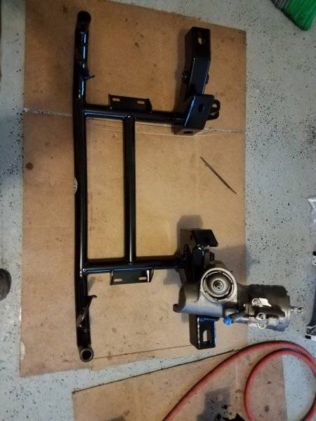

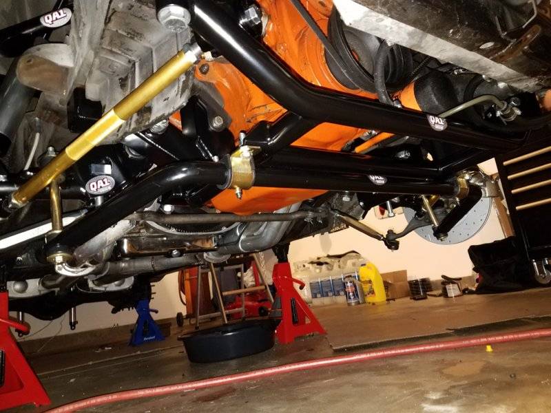

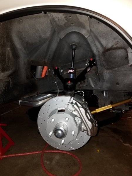

So I've been busy with a few upgrades over the winter, so far so good, she's out for a front end alignment now. I'll be getting her back soon. Upgrades include qa1 stage 3 front suspension, double adjustable shocks all around, gear box, starter, front disc brake conversion with booster and a few other things. Oh yeah, some power coating. Let me know what ya think. Thanks.
Doing some nice work I'd like to know how it handles and rides afterwards thanks for posting

Thanks, I appreciate the kind words.

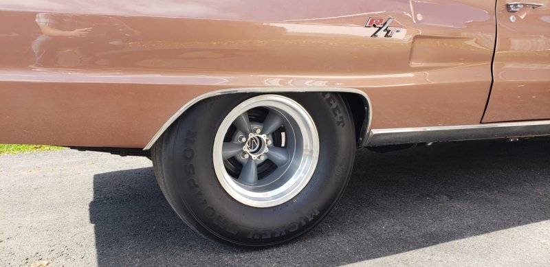

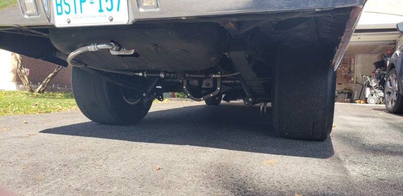

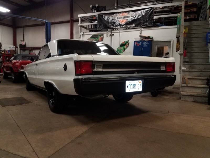

Rear tires are 315/60r15 on 10 inch wheels and front are 215/70r15 on 4.5 inch wheels.
Man that car looks killer I like the stance on that not too high in the back but not too low car looks good man you got anymore pictures post and that thing is badass what size tire do you run in the back and the front that is a good-looking ride
Yeah I'm kind of curious about the backspacing myself cuz I have a set of 15 x 10 steelies that one day I'm going to put under my car that sounds like a pretty good tire to throw into their I like the front tires I need some questions answered and you just help me

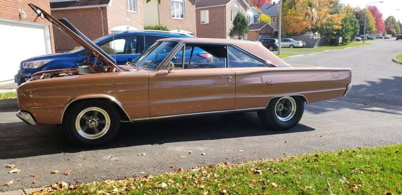

Just call me curious do you have any more pictures you can share up close and maybe the back view and another side shot I really like the way it sits
And I love the torque thrust on there that's what I'm going back to eventually I like those back one's to they look tough states with a flat centers it looks like is that correct that looks really good

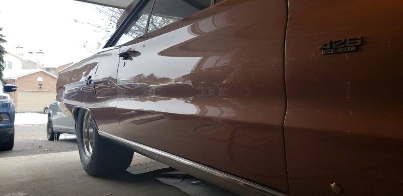

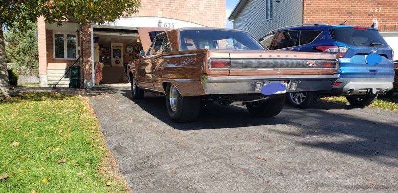

Here you go. Backspacing is 4 or 4.5 inches on the rear.

They're just HD springs with an extra inch lift. Also I used the US car Tool kit for the spring relocation and am using the middle mounting hole for the front spring mount.

Same thing on mine. IF I end up with the taller and wider tires I will do as you did and move the axle back a bit and add a leaf.
