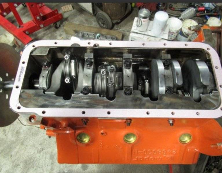

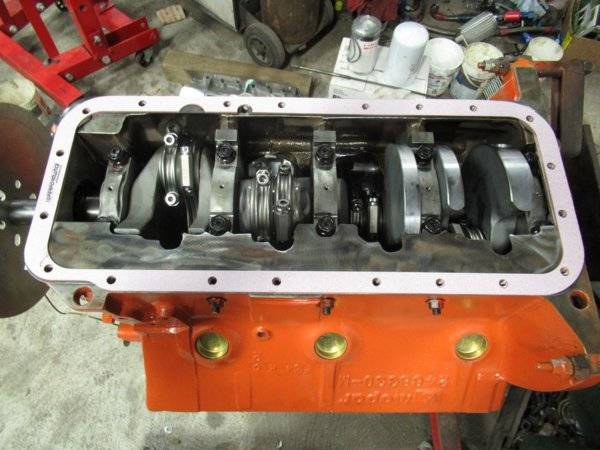

Why not? That is about what mine looks like with the drill. I have 25 psi of OP at hot idle.
A high volume pump and 8 qt pan and your gold.
