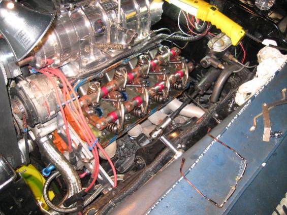

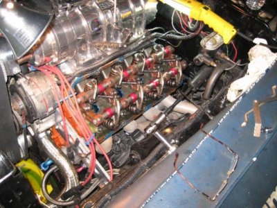

While you have the valve covers off,try to check the valve lash if you can.If it's a hydrolic there should not be any real clearance.Start at the front of one bank,rotate engine untill the intake valve is fully open and feel the exhaust rocker,is it tight?Rotate again and fell the intake,is it tight,will it move around at all??Check all of them and let us know whutcha feel:sleepy2:
