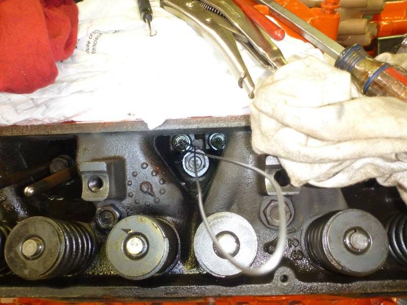

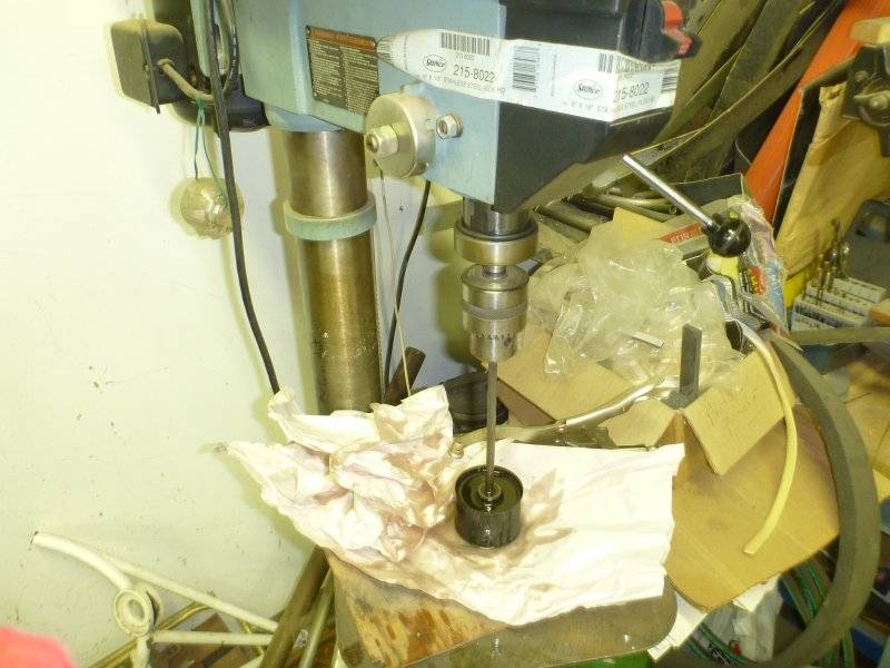

Pull the covers, find the "soft" one, pull the lifter and take it apart. Clean it all out, put it back together and then put it in a spray can lid full of oil. Use a drill press or arbour to cycle the lifter up and down until it pumps solid, put it back in.
